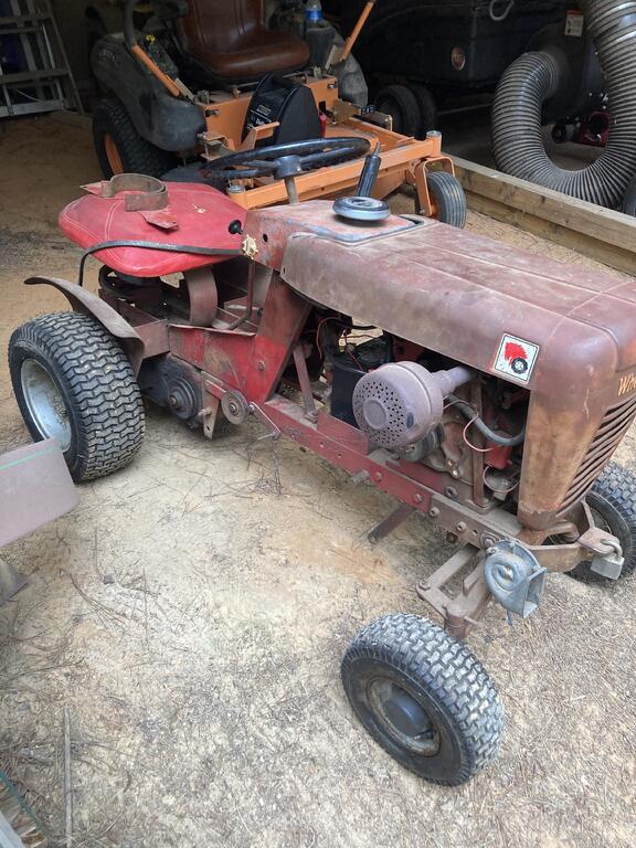

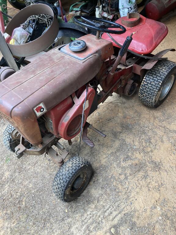

Hit Miss Man 6 #1 Posted October 30, 2022 I just purchased what I believe is a 1962 wheel horse 702. The serial number starts with a 62-. The Amp meter is between the throtle and choke cable. The push button starter is mounted below. It has a Kohler K161S engine that appears to be original. It has the square pan seat and a three spoke steering wheel. This is where i'm confused. If your sitting on the tractor the clutch / brake shaft on the right side that runs through the frame only extends out about 4 or so inches. It does not appear to have been cut off with a hacksaw or torch. It is smooth and some what beveled on the end. The person I got it had the book for a 1962 Wheel Horse Lawn Ranger 32R or 32E. ANY help would be appreciated. Thanks in advance. Paul 1 Share this post Link to post Share on other sites

Hit Miss Man 6 #5 Posted October 30, 2022 Serial #62-17155 2 Share this post Link to post Share on other sites
Pullstart 68,522 #6 Posted October 30, 2022 Definitely a lawn ranger 2 Share this post Link to post Share on other sites
Achto 30,194 #7 Posted October 30, 2022 (edited) 2 hours ago, Hit Miss Man said: 1962 Wheel Horse Lawn Ranger 32R or 32E. Yep, the manuals should be correct. '62 Lawn Ranger with an engine transplant. Edited October 30, 2022 by Achto 1 Share this post Link to post Share on other sites
Handy Don 15,179 #8 Posted October 31, 2022 Kinda looks like it has a nose ring with the padlocked front hitch. Share this post Link to post Share on other sites
Hit Miss Man 6 #9 Posted October 31, 2022 Thanks guys for all the help I appreciate it. But my first question is why is the clutch brake pedal shaft so short on one side?. Does anybody have the main belt guard or the brake pulley guard for sale that I can purchase? I’m sure I need a few more parts also as I would like to bring this little tractor back to its original condition 2 Share this post Link to post Share on other sites
gwest_ca-(File Mod) 11,845 #10 Posted October 31, 2022 I don't know why it is short but it is original. There is a tube that fits over it and shown in the ipl. Download the A-7136 file. Share this post Link to post Share on other sites

ri702bill 10,571 #14 Posted October 31, 2022 (edited) It has the later 8 HP style S/G belt guard, not from 1962. The 702 had a small bump-out dimple at the S/G, not the larger button shown. The model number under the K161S on the tag would be needed to ID the engine. The small tires and the matching small rear fenders say its a Lawn Ranger, not a 702. Is it me, or is the seat installed upside down??? Bill Edited October 31, 2022 by ri702bill Share this post Link to post Share on other sites
rmaynard 16,690 #15 Posted October 31, 2022 22 minutes ago, ri702bill said: Is it me, or is the seat installed upside down??? Bill Looks like a cushion. Share this post Link to post Share on other sites
