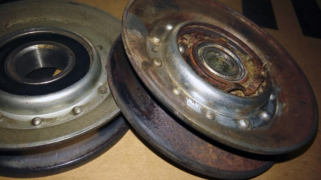

Lman 14 #1 Posted October 27, 2022 I needed a new tension pulley, the bearing on the old one was almost totally destroyed. Why do they make these things with lips, so that you can't press out the bearing? Is this cost-effective, does this use less metal? I know I shouldn't complain as I've also seen nylon ones. Not being able to press in a new bearing doubles the price of the part. Economic growth is all well and good, but seriously ... 1 Share this post Link to post Share on other sites
JoeM 9,302 #2 Posted October 27, 2022 I have had a bearing and not a pulley and made 6 equally spaced slices in the lips. put the pulley on a piece of pipe that fit into the recessed area and drove out the old bearing. tapped in the new bearing and bent the lip back over the bearing and worked out fine. some folks drill out the rivets and split the haves then bolt back together, but the slicing method worked just as good and quicker. Some old Wheel Horse machines used pulleys on the mule drive with clips and the bearings were replaceable. Old school casted sheaves. 4 Share this post Link to post Share on other sites
Achto 30,166 #3 Posted October 27, 2022 1 hour ago, JoeM said: some folks drill out the rivets and split the haves then bolt back together This is the route that I take. Does not take much time at all. 1 4 2 Share this post Link to post Share on other sites

Lman 14 #8 Posted October 27, 2022 @Achto Mighty fine job! It's interesting to see the evolution through time. Instead of 6 big rivets, 12 smaller ones in the more recent pulleys. I doubt I can get in with an axel grinder. Going to an old Tecumseh dealer tomorrow to pick up the belt, they told me I could have a look at their 2nd hand pulleys, see if there's a similar one, 75 mm OD, 17 mm hole. The OEM part is about €25 where I am. Bearing in the original is a 6203DDU. I believe they are also used in mowing decks, I possibly have some lying around. 1 Share this post Link to post Share on other sites
Achto 30,166 #9 Posted October 27, 2022 15 minutes ago, Lman said: Instead of 6 big rivets, 12 smaller ones in the more recent pulleys. I have used this same method on pulleys that are spot welded together. Drill the spot welds out, separate the haves, bolt them back together. Share this post Link to post Share on other sites
Achto 30,166 #10 Posted October 27, 2022 19 minutes ago, Lman said: I doubt I can get in with an axel grinder. I used a die grinder to flatten out the rivet heads. 2 Share this post Link to post Share on other sites

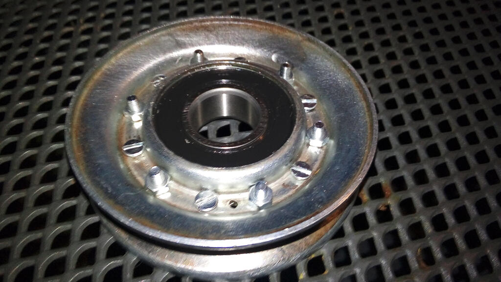

Lman 14 #18 Posted October 28, 2022 Thank you all for your encouragement. I managed to restore the pulley to working order with a new bearing. As someone suggested, I used a Dremel-like tool to grind down the spot welds till they were almost flush with the surface. Then I gently tapped a small mason's chisel in the groove while turning the piece over and over until the two halves came apart. DIY store here only had one kind of bolt in this small size and no washers so I made do. 2 1 Share this post Link to post Share on other sites

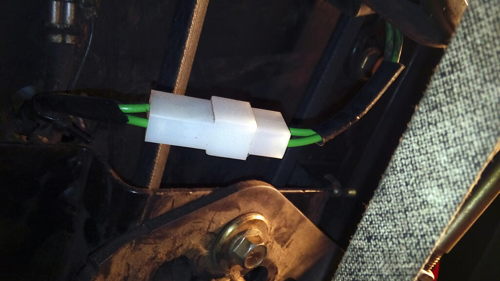

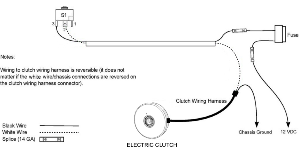

Lman 14 #23 Posted October 31, 2022 (edited) Okay, the drive belt is on. I cut the electric clutch cable without noting the two wires, which was not very smart. The general diagram below seems to suggest that the connection may be reversible, the wires on the clutch are both green. I'm sorry to ask such a noob question, but can I determine with a tester which is which, and if so, how exactly, or is this not necessary? I don't want to blow a fuse on the tractor. Edited October 31, 2022 by Lman Share this post Link to post Share on other sites
Jeff-C175 7,207 #24 Posted October 31, 2022 4 hours ago, Lman said: connection may be reversible, The clutch should be a simple electromagnet, and as the diagram says, polarity should not matter. 1 Share this post Link to post Share on other sites
Lman 14 #25 Posted October 31, 2022 (edited) 1 hour ago, Jeff-C175 said: The clutch should be a simple electromagnet, and as the diagram says, polarity should not matter. Thank you very much! Pictured here with the two new belts. Mowing all done, probably the last sortie of the season. P.S. How much should such a connector cost? I paid about €12 for five of these. If you order a set of 5 in Shanghai, they cost around 3 or 4 times less, including shipping. To illustrate that the manufacturing cost of these items seems almost nil, the professional service that delivers parts several times a day provided 25x of one of the terminals, probably because they did not have the 5X in stock. I suspect this was the case because they charged me only for the 5x package. Maybe it's just me, but I think finding a good deal even on these basic items is a lot of work, the deck is often stacked against you. Edited October 31, 2022 by Lman Share this post Link to post Share on other sites
