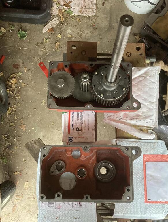

I gathered up the best parts from two transaxles. All nice and lubed in 30w & assembly grease.
(I'll install the hydro motor and last bolts after the transaxle is mounted...)

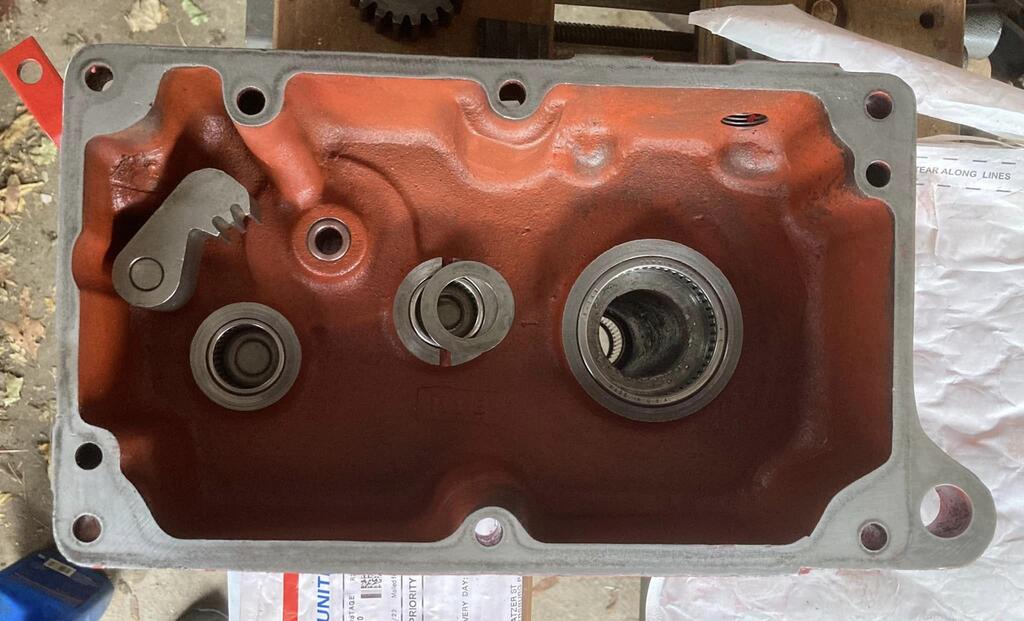

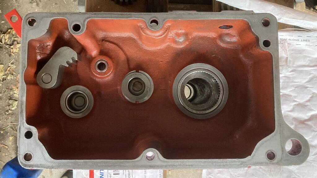

Parking Pawl in
Thrust Washer

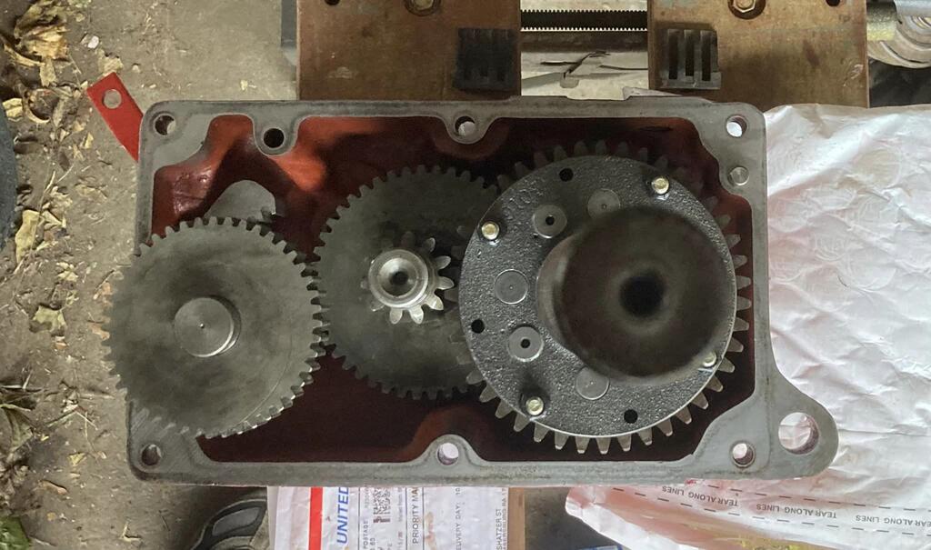

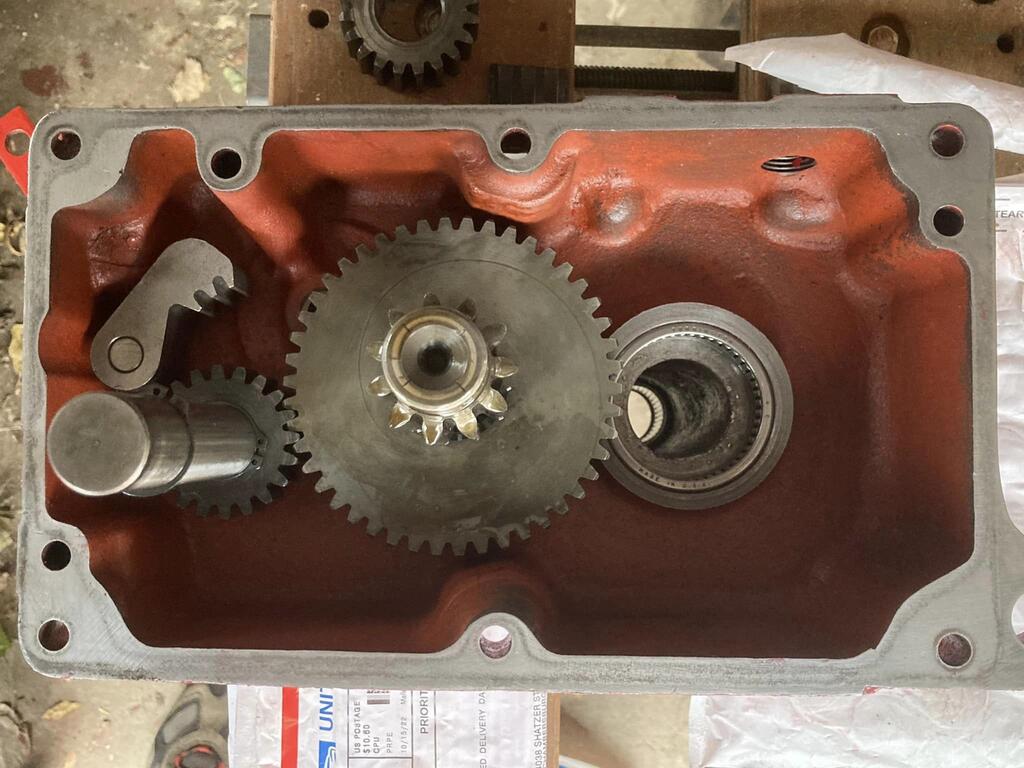

Dry fit 46T
Dry fit 44T

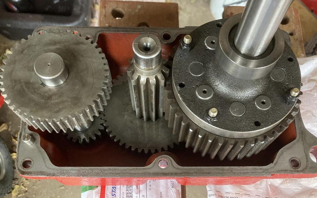

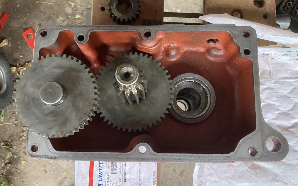

Held 46T aligned to the Differential and dropped down both, keeping 46T synced and through the Thrust washer
synced the differental with the 46T dropped through the Thrust Washer and into place next to the Differential.jpg
Grade 8 5/16th's bolts, everything turns smoothly, no grit nor unwanted debris

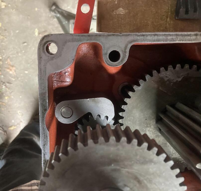

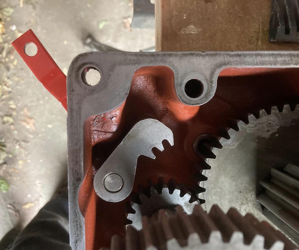

Parking Pawl engaged
Disengaged
Ready for the Gasket & 3/8th's Bolts, grade 5.
