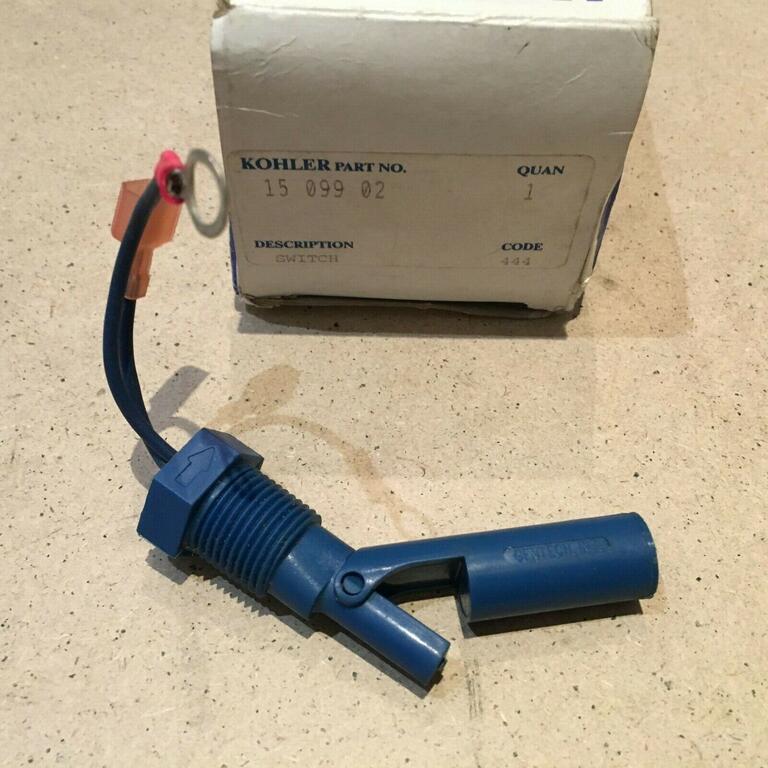

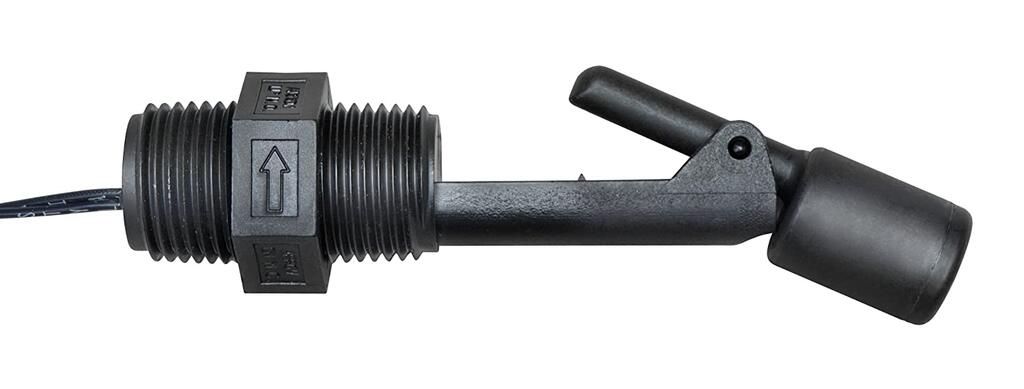

subvet720 179 #1 Posted October 26, 2022 (edited) When I purchased my WH 310-8, the oil level switch had been disconnected, and after removing the oil pan, I discovered that there were broken pieces of the switch in the bottom of the engine. Being compulsive as I am, I had to fix the switch. The Kohler part # 15 099 02-S is available, but is pricey. The company that originally manufactured them (Gemtech International) is now part of Tyco, and they no longer manufacture the needed version of the switch. I did find that a Madison M7700 has all the right specifications, and have one on order. The cost was $22 on Amazon, and I am hoping that my mighty Conrad Weiser Wheel Horse will have a functioning float switch and test switch by the weekend. I will post an update when I get the switch. Edited October 26, 2022 by subvet720 4 2 Share this post Link to post Share on other sites

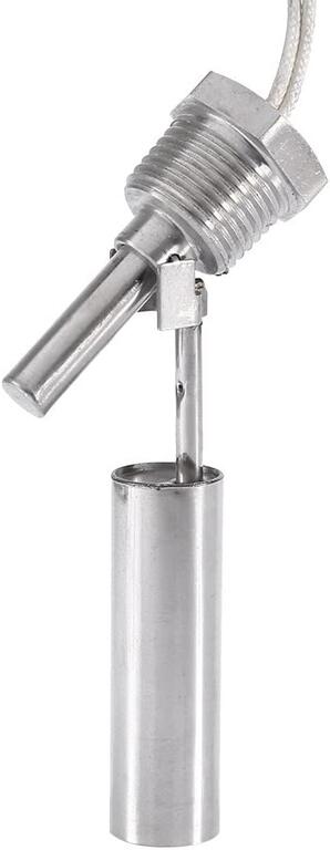

subvet720 179 #7 Posted October 27, 2022 After a little further investigation, mostly because I can't leave well enough alone, I have a stainless steel switch coming Friday. Hand crafted in China to exacting precision & detail, it set me back $9. By the time I have completed with this obsessive compulsive effort, I will have the best monitored oil on the planet A good submarine Torpedoman never lets an indicator light go un-used. 3 Share this post Link to post Share on other sites

subvet720 179 #12 Posted October 28, 2022 The Madison M7700 switch works like a charm. Unfortunately, although the SS switch looks cooler, it required too much room to activate and it won't work. I also disconnected the switch from the relay for the starter so that the tractor will start without the switch circuit, and I will make a mini harness to just activate the LED (replaced the incandescent bulb) if the oil goes low. I will also incorporate the test switch just because I like to make the LED light up without draining the oil. Makes me feel powerful 1 1 Share this post Link to post Share on other sites
