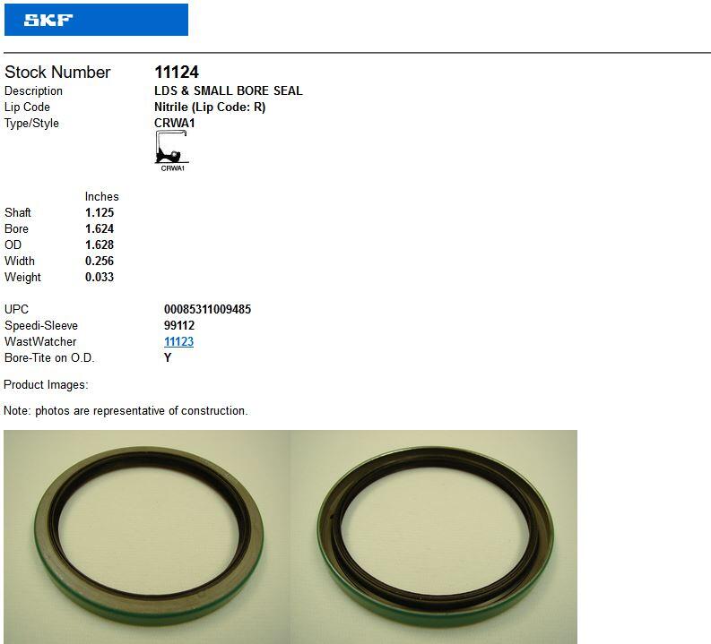

LFDRET 21 #1 Posted October 24, 2022 (edited) Does anyone know the size or number of the axle seals for a 1975 D-180 Edited October 24, 2022 by LFDRET 1 Share this post Link to post Share on other sites
953 nut 63,031 #2 Posted October 24, 2022 https://www.ebay.com/itm/283735244282?epid=1301882790&hash=item420ff03dfa:g:RMgAAOSwbm9eFNZ2&amdata=enc%3AAQAHAAAAoMvoYfuBUBUDYDXdS%2BUp79x3USGuQcjpq2qK3dhJvcPs41Mu5RhE818MjC27OmJMlLQy%2Fomi7bPfA3K2xAJB1ebHOvc7LnCCZUsLN6OTzxWN4V44qtPjMLNReOZGGHTZkcPWkNSSspI9r8vpSb9UtWuhK0rAcABoQn%2BI6DY4FKow0bV8%2B9btIrwYfrxC%2B7q4WTaKhhmPkGAikAS8AYrOLBM%3D|tkp%3ABk9SR8Sl2MWBYQ Share this post Link to post Share on other sites
