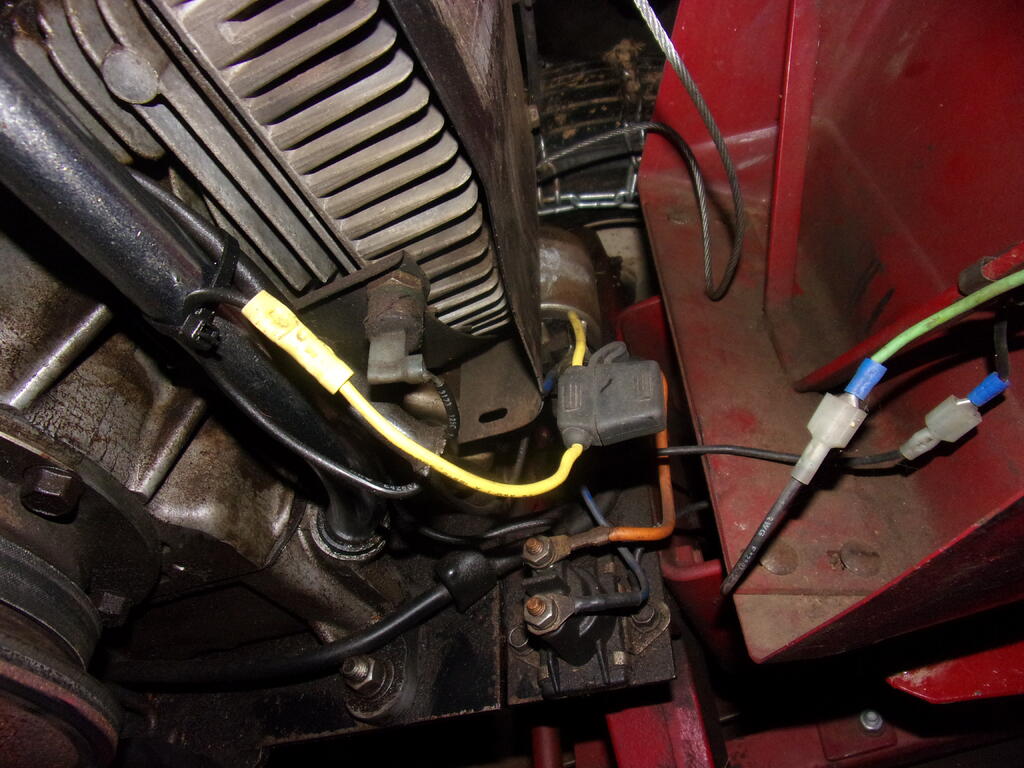

dr363305 50 #1 Posted October 22, 2022 Hello and good day. I have 1988 520H that is new to me. When I purchased it, the wires for the charging circuit were not connected and the gauges didn’t function. I wired it up per the wiring diagram and everything was good for a bit. Recently, the 30A fuse has been popping. There are no faults to ground that I have found. I put a voltmeter across the fuse holder and got 13.94V at idle and 15.6V at full throttle. Could the voltage regulator be causing this issue? Or am I completely wrong? Any assistance is appreciated! Feel free to flame me as well for being inexperienced with the Onan platform as well. Share this post Link to post Share on other sites

953 nut 56,739 #15 Posted October 23, 2022 35 minutes ago, dr363305 said: 15.6V was measured across the fuse. I do not think that reading matters. I need to check across the battery terminals for a more accurate reading. Measuring across the open fuse holder shows the NO-LOAD potential output of the charging system. The battery is a load and will indeed regulate the voltage seen when the fuse is in place. The fuse blowing randomly is probably telling you that the fuse holder is bad like @Ed Kennell said earlier. Your fuse holder is near the battery and over the years it has been exposed to battery acid fumes, not a good thing. The resulting corrosion acts like a resistor and heats up the fuse. @Save Old Iron gave us an explanation several years ago; f you have a 10 amp current flowing across a 1 ohm resistance (contact corrosion) the electronics formula to calculate power = current squared times resistance so 10 amps x 10amps x 1 ohm resistance = 100 watts !! 100 watts of connector heating is the same as laying a 100 watt soldering iron on the connector. 2 Share this post Link to post Share on other sites

dr363305 50 #17 Posted October 23, 2022 14 hours ago, 953 nut said: Your fuse holder is near the battery and over the years it has been exposed to battery acid fumes, not a good thing. This fuse holder is at the front of the engine by the starter solenoid. This isnt the fuse holders by the battery. Not debating if it is bad or not, just that the location is different. 10 hours ago, 8ntruck said: DO NOT CONNECT THE LEADS TO THE VOLT METER TOGETER! The magic smoke will escape, then things won't work anymore! Why would measuring voltage across the battery let out the magic smoke? Im not messing with any wiring on the voltmeter. Share this post Link to post Share on other sites

Ed Kennell 39,731 #19 Posted October 23, 2022 1 hour ago, dr363305 said: This fuse holder is at the front of the engine by the starter solenoid. Yes, this is the one that I have often found badly corroded. I replace them with a waterproof holder. 2 Share this post Link to post Share on other sites

dr363305 50 #22 Posted October 23, 2022 Update: Measured across the battery terminals and got 13.9V - 14.2V when running. Popped another fuse. I will replace the fuse holder and report back. Thank you all for the help! 1 Share this post Link to post Share on other sites
