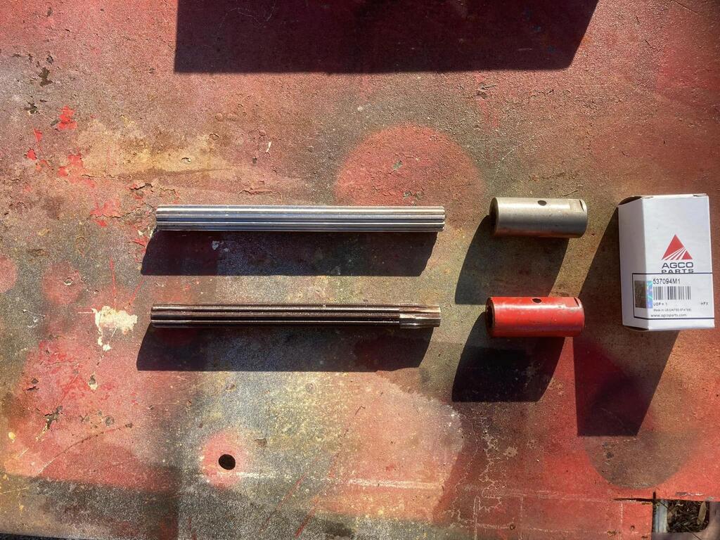

I found the worn spline & couplings at the edge, so off to find replacements.
"Always love the challenge of finding obsolete parts" Coupling 2-7502 Shaft 2-9539

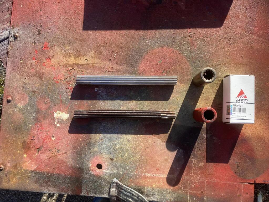

The factory spline really took a beating at the double sheave end of the 11 spline, as did the shaft as well. Typical issue with this design
I found the couplings out of warehouse in Chicago and the spline was machined of 4140 rated 160,000, so it matches the hardness of the couplings no problem
