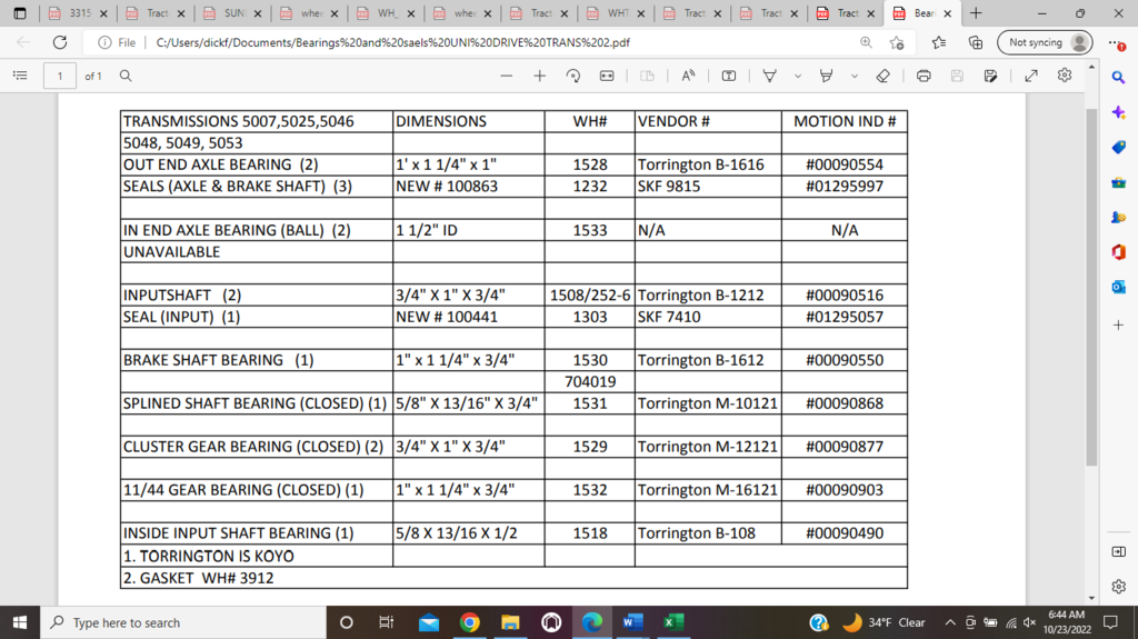

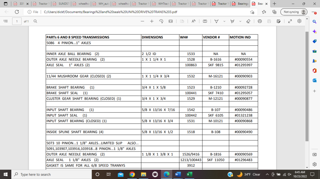

953 nut 63,003 #9 Posted October 23, 2022 17 minutes ago, ebinmaine said: 1977 B80 8 speed could be the larger 1⅛ axles. OK. I was going by the numbers I used on a one inch gear box. Here are the charts I saved from a previous post. 1 Share this post Link to post Share on other sites

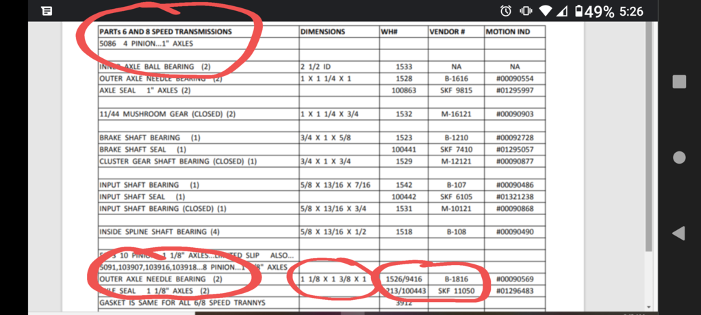

chalky493@yahoo.com 10 #10 Posted October 24, 2022 Anybody have a part number for the axle needle bearing for a 1977 B80 8 speed 1 1/8 " 1 Share this post Link to post Share on other sites
ebinmaine 75,742 #11 Posted October 24, 2022 In the 3rd chart above see where I've circled. Lowell at Wheelhorse Parts and More will have that and they're available at a GOOD local parts store. Share this post Link to post Share on other sites
