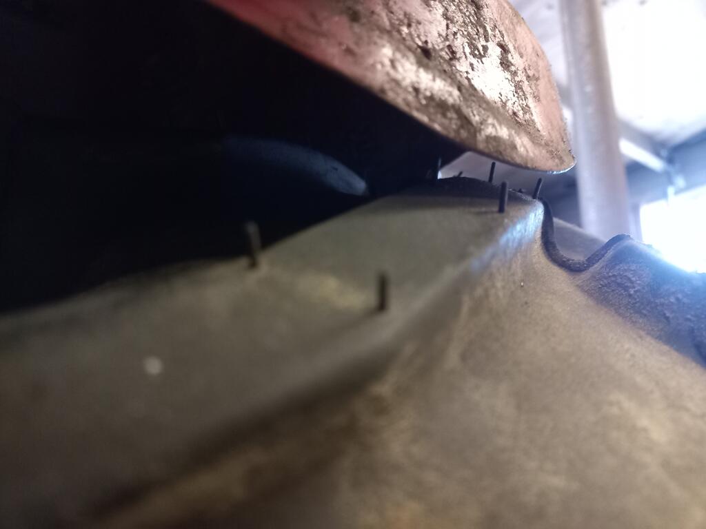

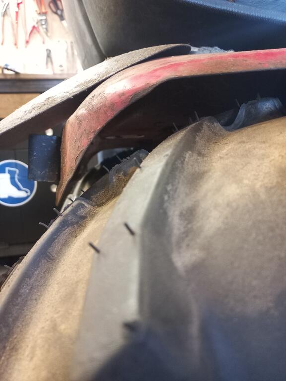

Thanks EB and I think you're right. Would'nt hurt to add a bit more air between the tire and the seat pan. The picture does make it seem worse than it is though.
Lee1977
I have full height 25 x 900 x 12 0n mt 312-8.  Added 1 3/4" under the fender bracket and a new cross piece and raised the gfront gas tank bracket also. Not much you can do bout the bar and foo
t board.
Edited by Lee1977
sjoemie himself
I've added a few washers. There's a solid 5/6mm or 3/16-1/4" space between the pan and lugs now. When I lean on it still just clears.
We'll give her a test like this.
Still looks bad..
But is actually OK (I think).
Long as you take it easy it'll be fine.
Just be sure to mention the small clearance to the other operator(s) of the tractor.
Worst case scenario is if it ever binds up you can trim the sheet metal in the area.

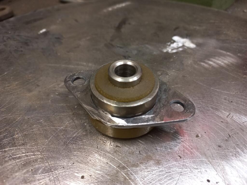

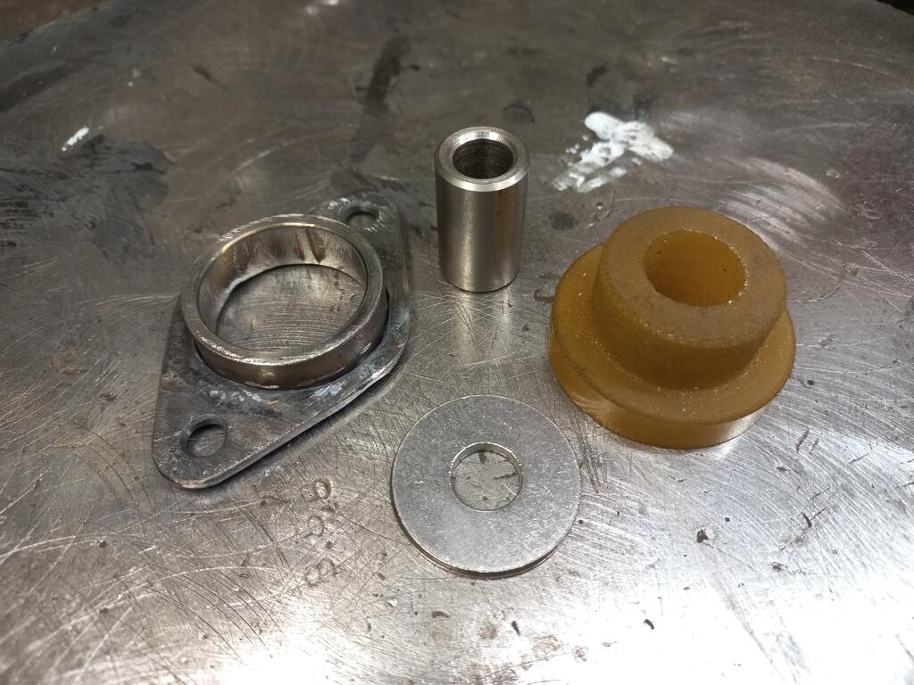

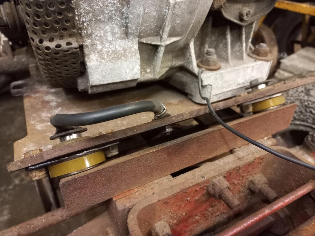

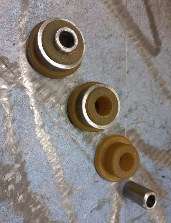

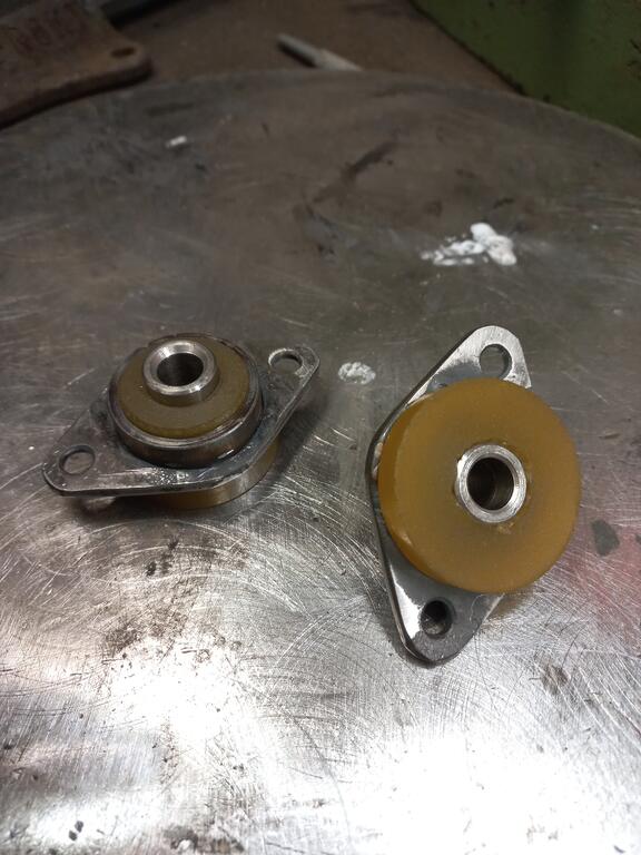

I decided to make my own engine mounts. Since I did not want to use solid mounts because of the Robin diesel engine I started snoopin' online. First I thought I would be able to utilise a standard component but that turned out to not be an option.
I wanted to improve on the original mounts so I bought some polyurethane roundstock to make bushings out of. Polyurethane is pretty popular amongst car enthousiasts because of superior properties over rubber. More flexible, durable and strong.
I gotta say this is the weirdest and nastiest stuff I ever turned in my lathe.
The rest of the mount is pretty much a copy of the original. I welded some stuff and pressed it all together.
All the pieces for one mount.

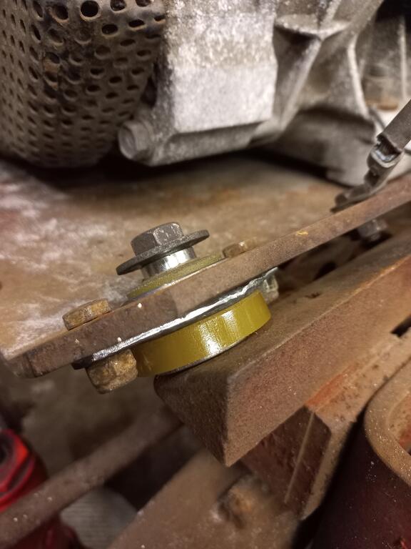

Everything together.
First one mounted. Fits like a glove.
2 down, 2 to go.
sjoemie himself

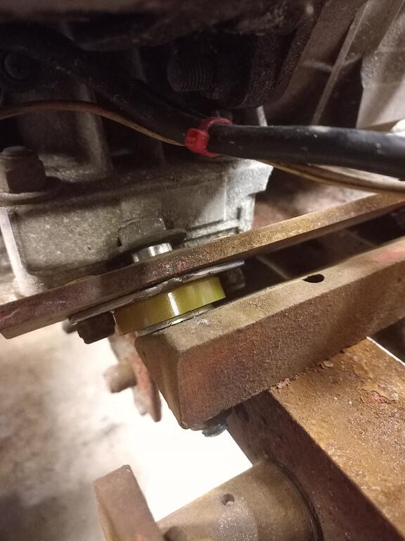

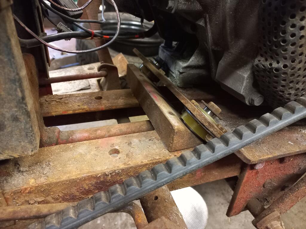

Last two are also installed. I would like a word with the engineer who dreamt up that it would be a good idea to put the Robin engine in there :blink:

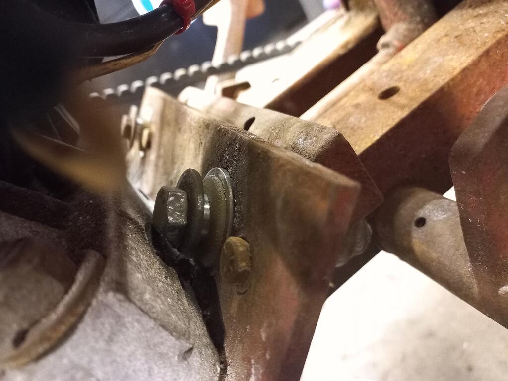

Mount number 3 was no problem but number 4 was a different story.. had to lift the engine with the triangle piece attached to get the bolts out and the engine mounts out/in.
Discovered that the triangle piece should be connected with two bolts, one of which is no longer there. For now I bolted it back down with just the one bolt installed.
Mount number 3, no problem.
Number 4, bolt is nearly hitting the crankcase.

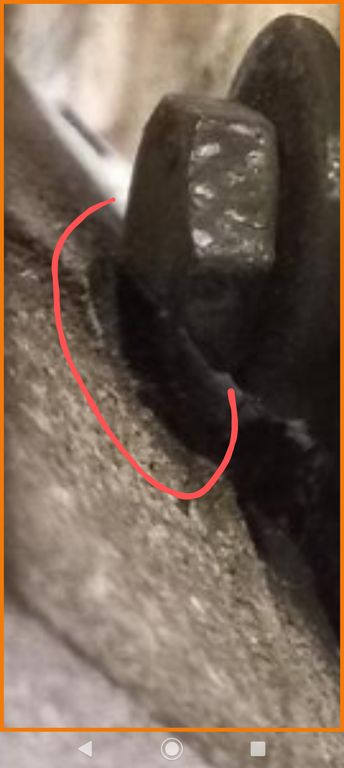

Head of the bolt was already modified. Stock or creative p.o?
Mark I zoomed in on your pic.
Look where I circled in red
Block worn? Or ground? Possible contact point which caused both block and bolt to wear?
sjoemie himself
@ebinmaine yep, the casting is worn away a bit.
Nothing to worry about since it's just the 'foot' of the engine so to say.
Probably a p.o. solution because the bolt is also metric instead of imperial..
That being said, don't think a imperial bolthead is much smaller than the current one.

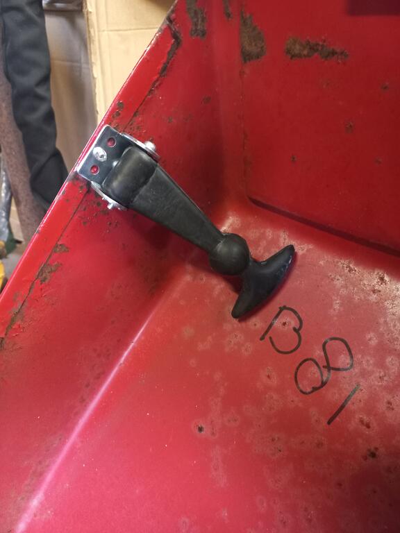

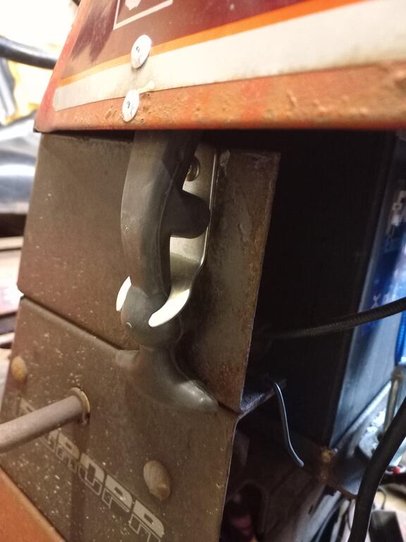

Minor progress, fixed/added new hood latches. Purists look away (again). I found the right style latches but they are a bit on the big side. That being said, they do work fine.
Might have to trim down the rubber bit that's pointing inwards or flip it around.
Handy Don
Functional folks, pay attention, of course! Thanks.
sjoemie himself

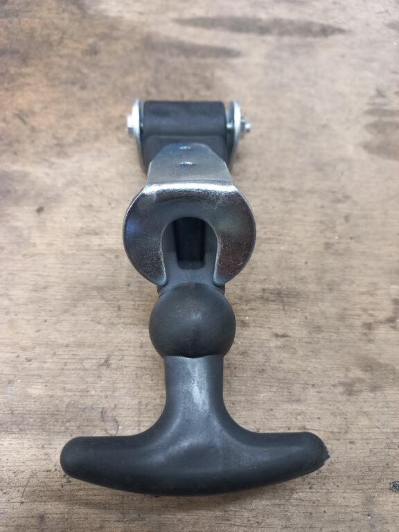

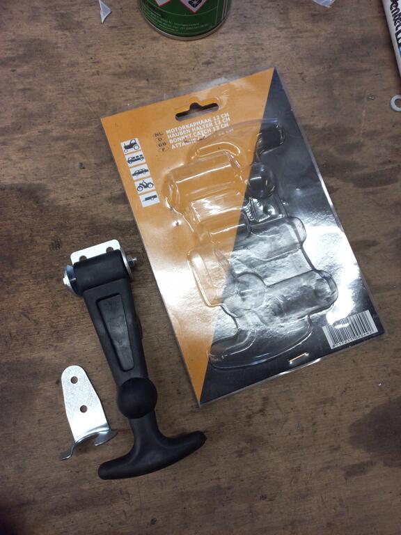

Had a fun experience shopping for these latches.. the ones I installed were the second set I purchased.
The first set was produced faulty. When you look at the picture below, notice that the 'rubber' part is wider than the holder. In other words there's no way to actually latch these latches.
I wrote 'rubber' because these things are about as flexible as a piece of concrete, okay maybe not that bad but certainly more like an ABS plastic than rubber.
I mean, I know that overseas stuff is not always that great but this just straight up can not work. I found it pretty hilarious to be honest.
All in all I would rate this product a solid 2/10.
The looks and size are good, just a pity it doesn't work at all.
Would not recommend :mrgreen:

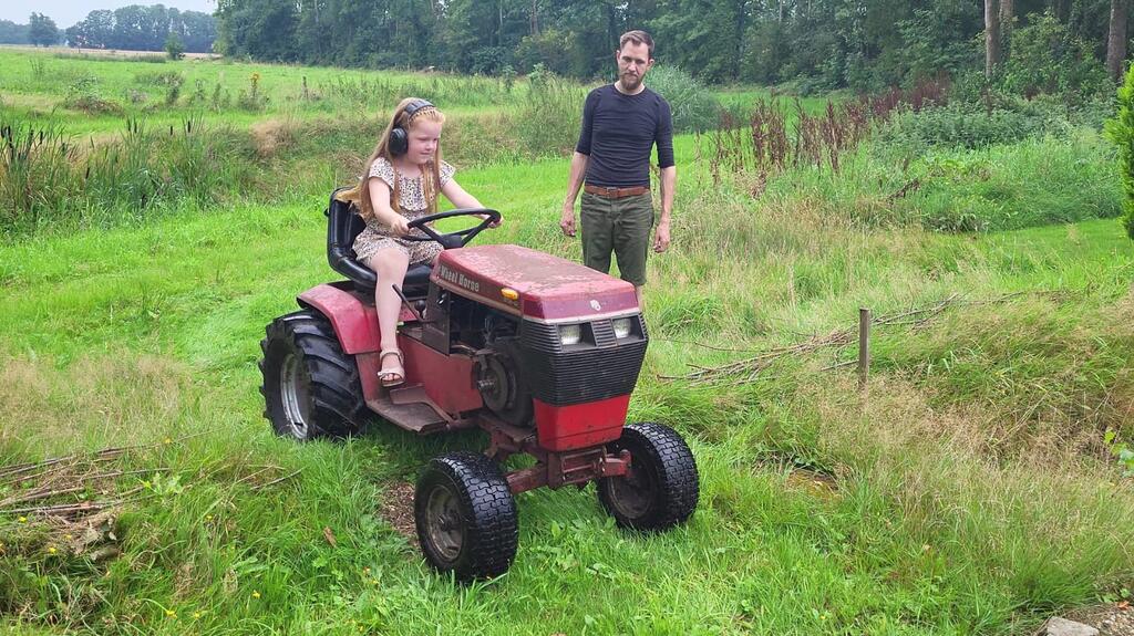

Starting with the good. My sister and brother in law came to visit us today together with their three kids. They were'nt very interested before but now wanted to ride the 'ol Wheel Horse.
Took them for a ride and after a while let them ride it themselves (2nd gear, low range :law-policered:)
This one was with the engine off ofcourse! :law-policered:

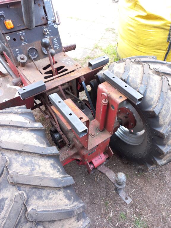

      A while ago I picked up a Canadiana 5hp heavy duty tiller. It features forward and reverse control and you could buy add on implements for it.
      My example unfortunately suffered a catastrofic engine faillure a.k.a. 'window' in the block. Hence it was cheap so I picked it up. The idea I had for it was to mount it on the rear of my 'Murray to IH 1568' build. However since I bought a Wheel Horse i've been thinking about mounting it on the front of that tractor.
      This is what i'm thinking..
