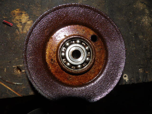

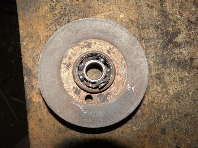

If your pulley does not move at all, the chances are that the inside of your pulley looks like this, and you must invest in a new pulley.

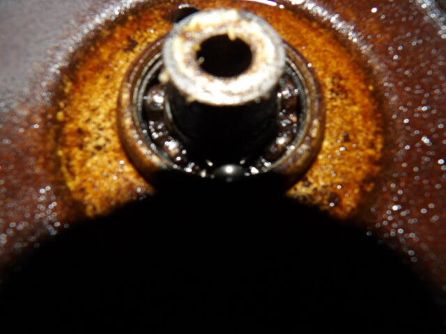

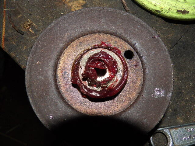

Bearings before cleaning:

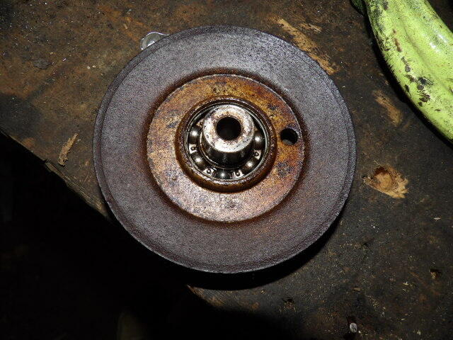

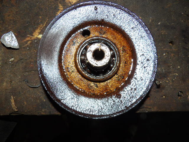

Same bearings after cleaning:
Much better, right?
If you desire, you can take a stiff toothbrush and get into the bearings a bit to clean them even better. Make sure to flush the bearings very well with your penetrating oil.

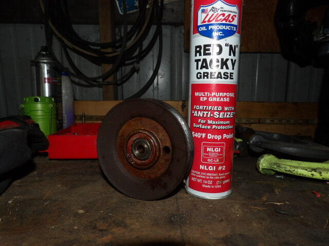

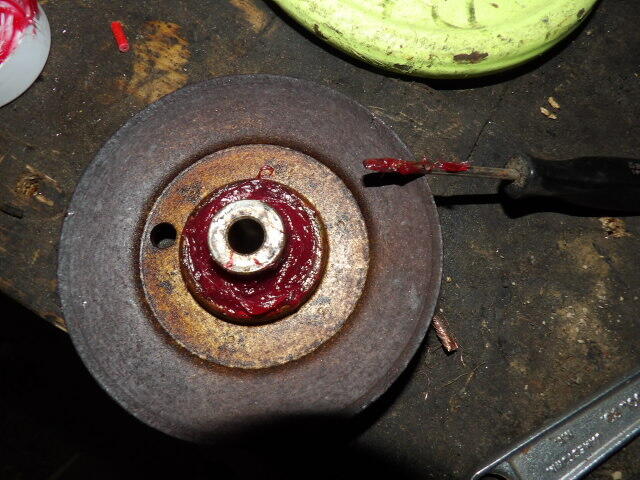

The next step is to get yourself a very small screwdriver, and use the grease of your choice (I recommend Lucas Red and Tacky). Press the grease into the bearings until the bearing area of the pulley is full of grease. Turn the pulley over, and do the same thing to the other side of the pulley, packing grease on the other side of the bearings.
After pulley is full of grease, press the bearing caps back into place with 2 small screwdrivers. Ensure that the caps go all the way in, squeezing out a bit of grease around the edges of the pulley bearings.
