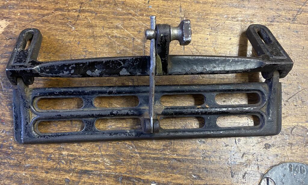

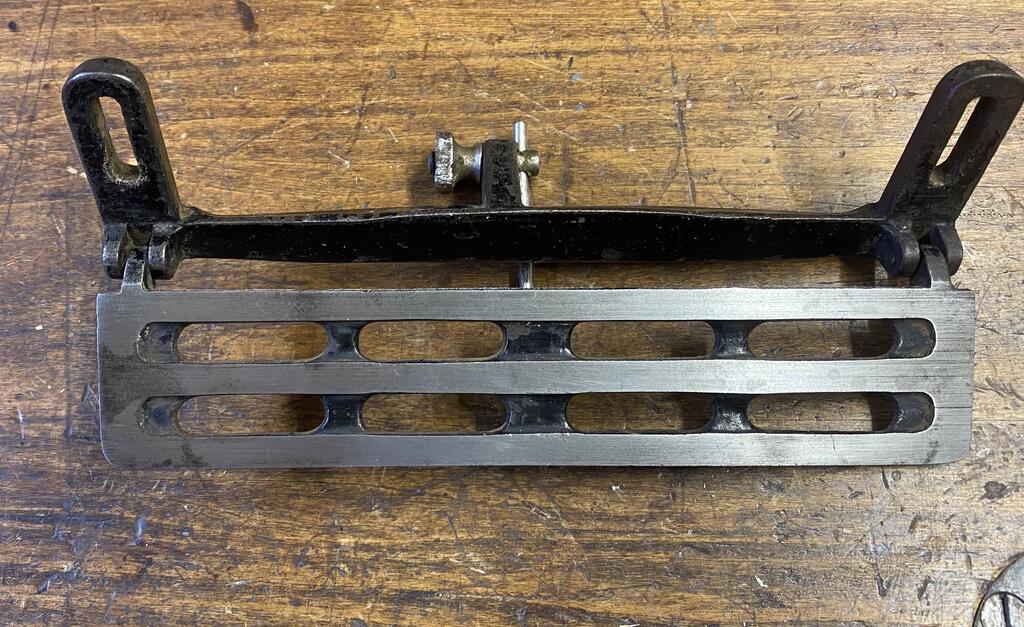

formariz 11,994 #1 Posted October 17, 2022 This weekend dug out one of my favorites and very essential accessory. Can any one tell me what it is for? 3 Share this post Link to post Share on other sites
stevasaurus 23,072 #2 Posted October 17, 2022 Hi Cas !! It looks like a bevel gage. 2 1 Share this post Link to post Share on other sites
Handy Don 13,340 #3 Posted October 17, 2022 Mounts to a cutting or shaping tool to align its cut to the other surface. 2 Share this post Link to post Share on other sites
8ntruck 7,390 #4 Posted October 17, 2022 (edited) Angle guide for a jointer or maybe a shaper? Adjustable shooting board for making beveles with a hand plane? Edited October 17, 2022 by 8ntruck 2 Share this post Link to post Share on other sites
Pullstart 64,581 #5 Posted October 17, 2022 Futon for a squirrel? 1 1 1 Share this post Link to post Share on other sites
953 nut 57,969 #6 Posted October 17, 2022 Don't know the proper name but my uncle called it a "Third Hand". It attached to the side of the work bench a few feet from the vise to hold a long workpiece at the correct height. When not in use it would fold down out of the way. 1 1 Share this post Link to post Share on other sites
Darb1964 1,093 #7 Posted October 17, 2022 Almost looks like a small break. 1 Share this post Link to post Share on other sites
The Freightliner Guy 1,335 #8 Posted October 17, 2022 I know one thing that it ain’t. A cheese slicer 4 Share this post Link to post Share on other sites
Jeff-C175 7,203 #9 Posted October 18, 2022 I had something very similar but I can't remember what it was for! I had a good memory but I can't remember when! 1 2 Share this post Link to post Share on other sites

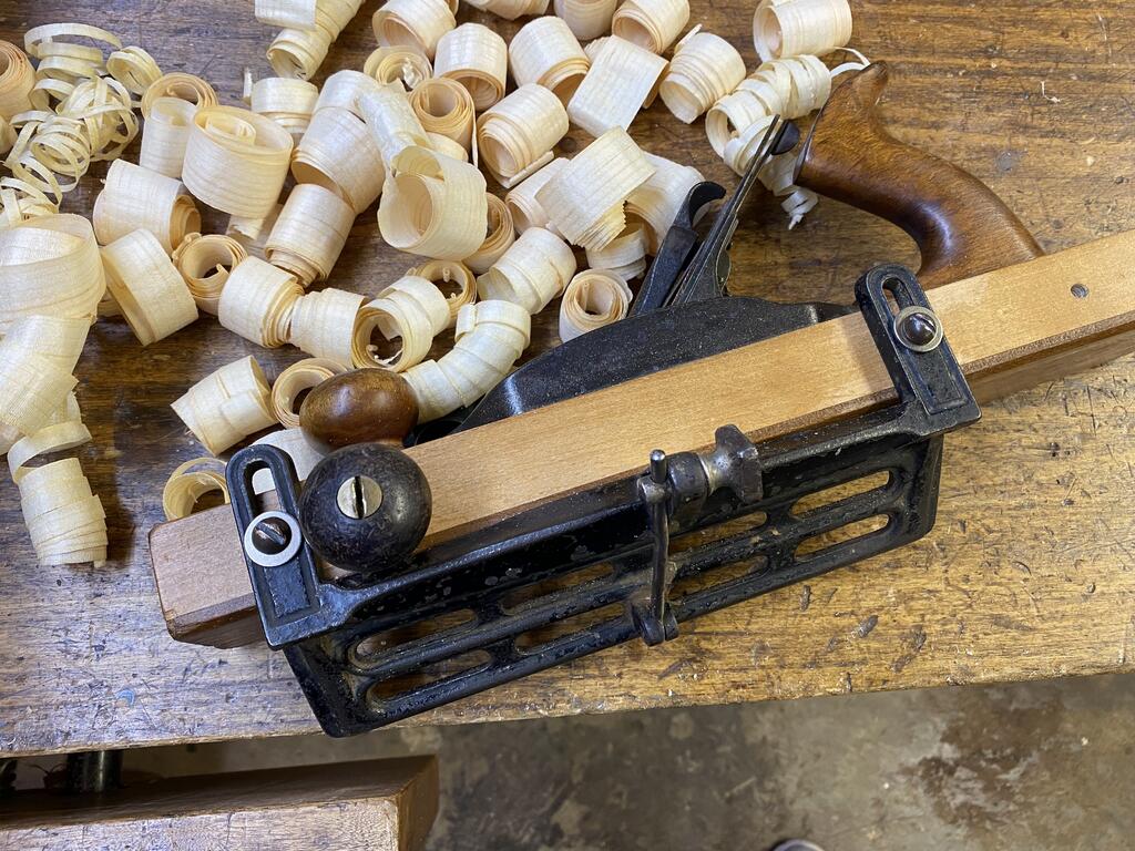

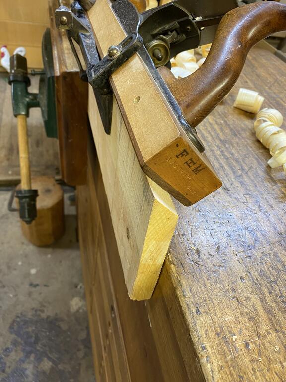

formariz 11,994 #10 Posted October 18, 2022 6 hours ago, 8ntruck said: Adjustable shooting board for making beveles with a hand plane? Some of you had the right idea . @8ntruckThis one is the closest to what it actually is. It is called a “ Jointer Gauge”. It attaches to a hand plane and it is used as a guide to keep plane cutting a square edge or at any other angle desired. This one is used for a wood plane but they were also made for metal planes. 1 4 Share this post Link to post Share on other sites
