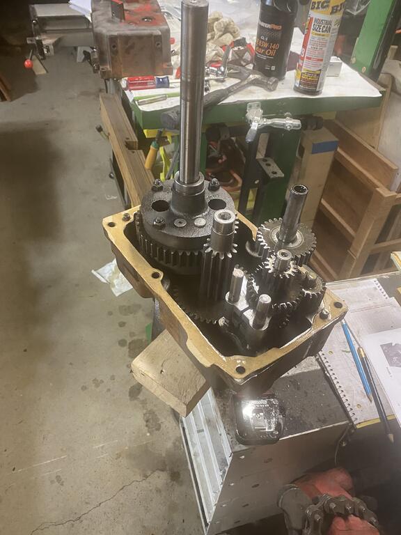

"Manic-Mechanic" 1,228 #1 Posted October 16, 2022 (edited) I am curious to get a vote on using a OEM Gasket or Silicone when sealing up the Case on the Transaxle I never had much luck with the "goop" Now this I have actually painted on both sides of a gasket, very thin smear. However, getting it apart again would take more than a Wood Chisel... Edited October 16, 2022 by "Manic-Mechanic" Share this post Link to post Share on other sites
ebinmaine 70,699 #2 Posted October 16, 2022 The gaskets are likely available from Lowell if not from the dealer. On a manual transmission you could get away with silly-cone but why... Just get the gasket and do it right. On a hydro transmission NEVER use the muck. It isn't user friendly to the fluid pump or passages. 4 2 Share this post Link to post Share on other sites
ri702bill 8,963 #3 Posted October 16, 2022 (edited) On the 4 speed I redid for the 502, I used a few dabs of the Permatex #2 non-hardening gasket goo , only on one side of the gasket, to keep the gasket flat and in place during the assembly - no issues, no leaks... Bill Edited October 16, 2022 by ri702bill 3 2 Share this post Link to post Share on other sites
953 nut 57,862 #4 Posted October 16, 2022 34 minutes ago, ri702bill said: to keep the gasket flat and in place during the assembly Ask your wife if you can have a couple of feet of thread. She will ask why, just tell here it is a secret. Tie the gasket in place at all bolt holes to hold it while the other half is being fitted in place. As bolts are placed in each hole cut and remove the thread, just that simple. 6 6 Share this post Link to post Share on other sites
ebinmaine 70,699 #5 Posted October 16, 2022 31 minutes ago, 953 nut said: Ask your wife if you can have a couple of feet of thread. She will ask why, just tell here it is a secret. Tie the gasket in place at all bolt holes to hold it while the other half is being fitted in place. As bolts are placed in each hole cut and remove the thread, just that simple. That's a neat idea! 2 Share this post Link to post Share on other sites
squonk 42,516 #6 Posted October 16, 2022 1 hour ago, 953 nut said: Ask your wife if you can have a couple of feet of thread. She will ask why, just tell here it is a secret. Tie the gasket in place at all bolt holes to hold it while the other half is being fitted in place. As bolts are placed in each hole cut and remove the thread, just that simple. Or cut a couple bolt heads off some long bolts and make studs. Use them to hold the gasket and align the haves. When 2 original bolts are in, remove the studs. Save the studs for another project. 5 3 Share this post Link to post Share on other sites
ri702bill 8,963 #7 Posted October 16, 2022 3 minutes ago, squonk said: and make studs. Use them to hold the gasket and align the haves. Similar to the two 1/2 -13 threaded rod guides I made back in the 60's to install 4 speed GM transmissions - better than doing the balancing act trying to get thru the clutch and into place. The aluminum case Muncies were not too bad, but the cast iron Saginaws were a lot heavier... 4 Share this post Link to post Share on other sites
"Manic-Mechanic" 1,228 #8 Posted October 16, 2022 5 hours ago, ebinmaine said: The gaskets are likely available from Lowell if not from the dealer. On a manual transmission you could get away with silly-cone but why... Just get the gasket and do it right. On a hydro transmission NEVER use the muck. It isn't user friendly to the fluid pump or passages. Yes, I picked up one from Lowell. Then I'll get the surface as clean and flat as possible. Share this post Link to post Share on other sites
pacer 3,175 #9 Posted October 16, 2022 4 hours ago, ri702bill said: , to keep the gasket flat and in place during the assembly This is my choice on many of my projects. 2 hours ago, squonk said: 3 hours ago, 953 nut said: Or cut a couple bolt heads off some long bolts and make studs. This is also a very good 'helping hand' in some cases. Basically I try and use as little 'stick-um' as possible. Share this post Link to post Share on other sites
Heatingman 971 #10 Posted October 16, 2022 Cut out yourself gasket material is available at every auto supply store. Thats what I did. Worked well, no leaks. But I do make gaskets all the time at work, so its a skill Ive honed over the years. Just take an empty half, trace it out, cut it out, then take that place it on the mating surface, and lightly take a ball peen hammer around the perimeter. That will get you the inside edge, and bolt holes. took about 15 minutes start to finish on this one. I find angled sheet metal snips to be ideal for cutting out gasket material. 1 2 Share this post Link to post Share on other sites
"Manic-Mechanic" 1,228 #11 Posted October 16, 2022 3 hours ago, Heatingman said: Cut out yourself gasket material is available at every auto supply store. Thats what I did. Worked well, no leaks. But I do make gaskets all the time at work, so its a skill Ive honed over the years. Just take an empty half, trace it out, cut it out, then take that place it on the mating surface, and lightly take a ball peen hammer around the perimeter. That will get you the inside edge, and bolt holes. took about 15 minutes start to finish on this one. I find angled sheet metal snips to be ideal for cutting out gasket material. Nice, very nice. I especially like the little tab to place the gasket. 2 Share this post Link to post Share on other sites
"Manic-Mechanic" 1,228 #12 Posted October 16, 2022 3 hours ago, pacer said: This is my choice on many of my projects. This is also a very good 'helping hand' in some cases. Basically I try and use as little 'stick-um' as possible. I usually have no issue placing the other half case, not on these little transaxles anyway. 1 Share this post Link to post Share on other sites
pacer 3,175 #13 Posted October 16, 2022 4 hours ago, "Manic-Mechanic" said: lightly take a ball peen hammer around the perimeter. That pretty well describes my method exactly - I have a small ball peen (looks like a toy!) that allows met to tap-tap the bolt holes with that small ball end and the hammer end is just right to "cut" the other edges. I usually do the holes first and stick the bolts to be used in the holes to help in keeping it in place One of my favorite gasket materials is a cereal box - Cheerios, cornflakes, etc. I will .... lightly - dab oil around the perimeter surface and then lay the cardboard on that which gives me a "print" of the shape. I prolly make more of my gaskets than I buy! 1 Share this post Link to post Share on other sites
"Manic-Mechanic" 1,228 #14 Posted October 17, 2022 2 hours ago, pacer said: That pretty well describes my method exactly - I have a small ball peen (looks like a toy!) that allows met to tap-tap the bolt holes with that small ball end and the hammer end is just right to "cut" the other edges. I usually do the holes first and stick the bolts to be used in the holes to help in keeping it in place One of my favorite gasket materials is a cereal box - Cheerios, cornflakes, etc. I will .... lightly - dab oil around the perimeter surface and then lay the cardboard on that which gives me a "print" of the shape. I prolly make more of my gaskets than I buy! Cheerios would be my box of choice...but then whatever is emptiest. Share this post Link to post Share on other sites
