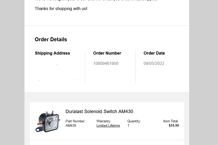

Snoopy11 5,717 #12 Posted October 16, 2022 2 minutes ago, Jeff-C175 said: That's total bull5h1t which I would not accept. I'd be going to corporate. You bet it is. (I erased my address... but here is the order print out that I took to the store with me). Don Share this post Link to post Share on other sites
Evguy 556 #13 Posted October 16, 2022 (edited) 11 minutes ago, Jeff-C175 said: That's total bull5h1t which I would not accept. I'd be going to corporate. I agree! I would not put up with that crap I never get asked for boxes from my brake parts. I would ask to see policy that states that Edited October 16, 2022 by Evguy 1 Share this post Link to post Share on other sites
