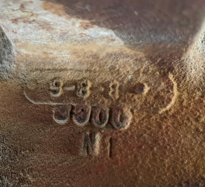

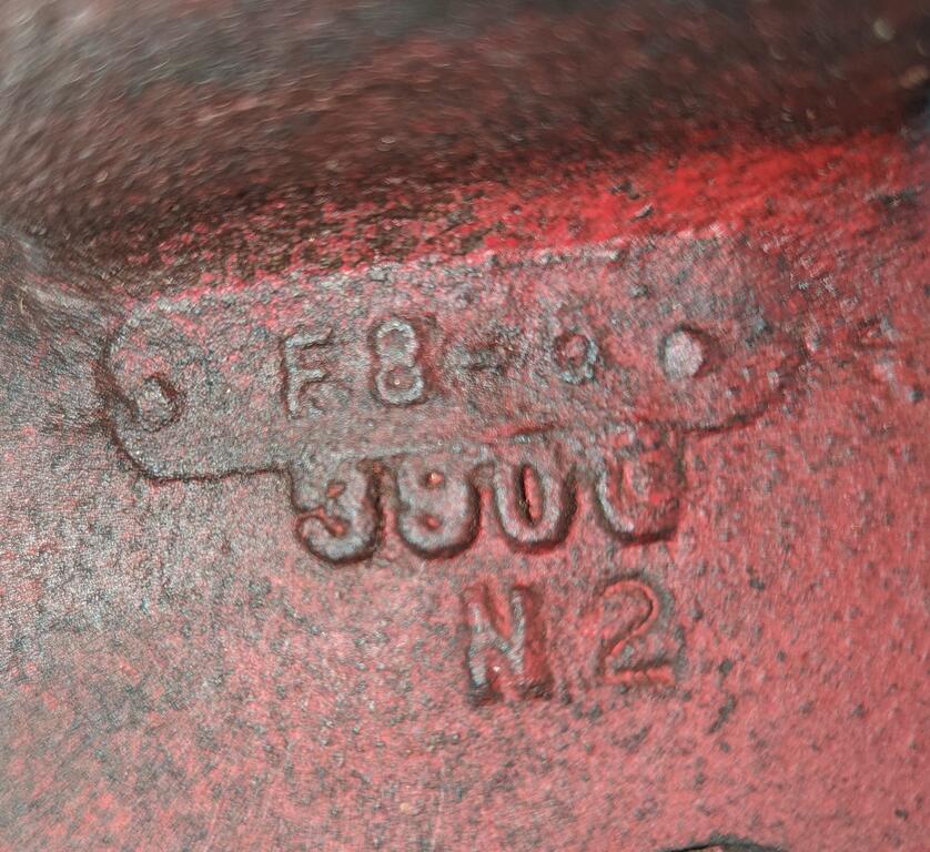

stevasaurus 23,058 #7 Posted October 12, 2022 In the 1st picture...F8 - ? is the casting date. "F" equates to June (6th month). "8" is the 8th day of that month. Not sure what that last number is, but it is the year. 3900 is the WH part number for the casting. I have no idea what N 2 or what N 1 means in the 2nd picture. 9-8-8 would be September 8 1958 or 1968 depending on the casting. A 3 piece trans casting would be 1958. One easy thing you could do...pull out the shifter and take a look down the hole with a flashlight. You will be able to see your shift forks and some of the shift rails and if they are rusty. You can also move the shift forks with a large screwdriver to view a little more. That should give you a good idea what the inside looks like and if it might be a good idea to open it up. If it is rusty, any rust that happens to get removed by using the horse is going to settle on the bottom as sludge. The transmission you have can be narrowed down by a couple of pictures. Where is the brake drum located in relation to the rear axle?? What diameter axles do you have?? (remember the Heavy Duty 3 speed transmissions had 1 1/8" axles) 1 Share this post Link to post Share on other sites
