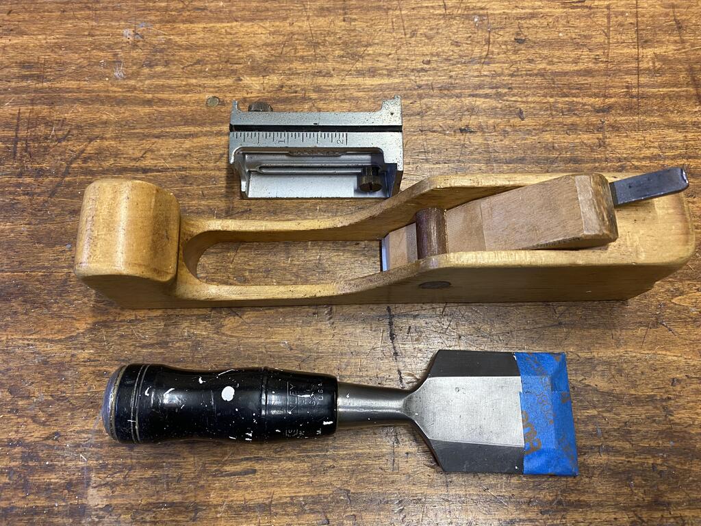

lynnmor 7,545 #1 Posted October 11, 2022 Common tool not so many year ago. 2 Share this post Link to post Share on other sites
formariz 11,993 #2 Posted October 11, 2022 Or it’s alternatives for a crisper job. 1 Share this post Link to post Share on other sites
JAinVA 4,629 #3 Posted October 11, 2022 (edited) Dare I say it. A butt marker. Now most hinges have radiused corners Edited October 11, 2022 by JAinVA Share this post Link to post Share on other sites
formariz 11,993 #4 Posted October 12, 2022 42 minutes ago, JAinVA said: Dare I say it. A butt marker. Now most hinges have radiused corners Only inexpensive stamped ones. Good quality architectural hinges always have square corners. Inexpensive round corner hinges were developed for production work such as in prehung doors so they could be machine mortised without needing hand work to square corners. 1 Share this post Link to post Share on other sites
