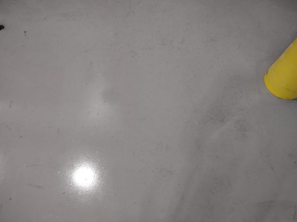

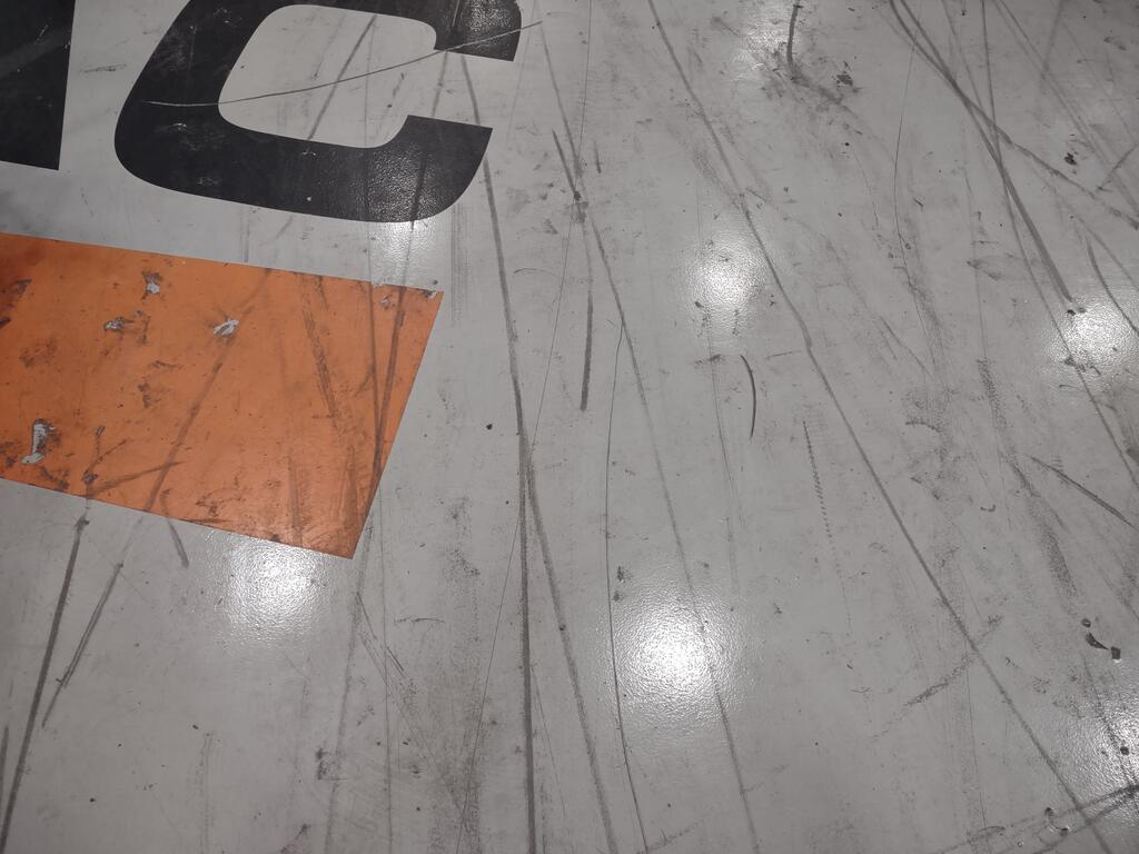

Achto 28,777 #6 Posted October 7, 2022 Just want to share some pics of the very expensive epoxy floor in our "new" test cell at work. This floor is about 18months old. Looks purty, right? The above pic is near the wall. Let's take a look at what sees traffic and is the work area. 4 Share this post Link to post Share on other sites

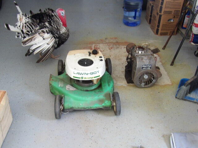

Snoopy11 5,717 #16 Posted October 7, 2022 Wow guys, not trying to start WW44.1 here... but... I have used Rustoleum epoxy concrete garage paint on 2 garages and never had it peel... I clean the 'crete very well before I use it, (the cleaning, etching liquid comes with the paint kit)... then I go with primer, then paint, then flakes. The only reason that I have ever had issues with epoxy concrete paint is due to the golf cart leaking battery acid all over the floor, which you can see in this picture... (you can see that the rest of the floor in this picture is just fine)... and I plan to primer and repaint the bare area in this photo very soon since the cart now has sealed batteries in it... The floor is a little dirty in this shot... but here is a better shot of my floor.... Don 3 Share this post Link to post Share on other sites
