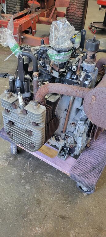

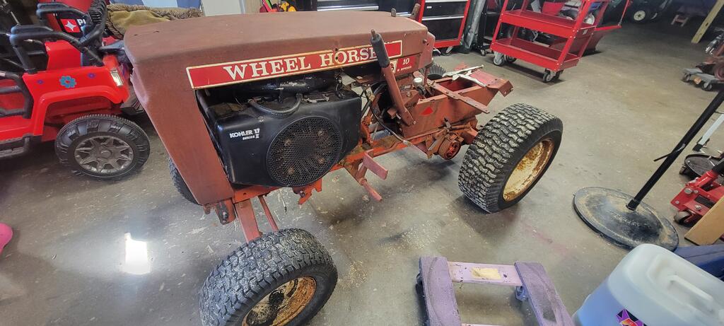

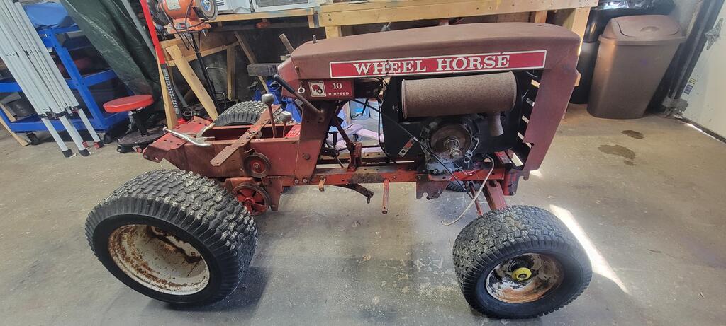

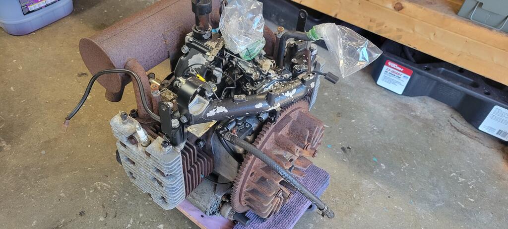

OldWorkHorse 3,129 #1 Posted October 6, 2022 (edited) So I'm starting a new project with a 1973 no name @ebinmaine found for me and a series 2 I picked up off another tractor back in the day. As long as it passes the start and run test, but if it does the goal will b to cram it under the hood and make a 1973 no name 17 aka 7317. This may be a slow going project just with everything going on and in the next few weeks having to go under the knife and a roughly 6 week recovery after, so shop life might be limited but it will be picked away at and posted here. Edited October 7, 2022 by OldWorkHorse 4 8 Share this post Link to post Share on other sites
Moparfanforever 896 #2 Posted October 6, 2022 Looks like a cool project!! Always wondered if a KT or a Mag 18 would fit under the hood of that style tractor. I see it has the oil filter block off plate on it, are you putting an oil filter on it ?? 2 1 Share this post Link to post Share on other sites
OldWorkHorse 3,129 #3 Posted October 6, 2022 (edited) 47 minutes ago, Moparfanforever said: Looks like a cool project!! Always wondered if a KT or a Mag 18 would fit under the hood of that style tractor. I see it has the oil filter block off plate on it, are you putting an oil filter on it ?? Yes it's going to get a oil filter and pressure gauge once passes the worth putting money into test. And as for fitting it will.... whether or not this project becomes bigger then I want it to and frame and hood get stretched is a differnt story BUT it will fit I enjoy the old style of these and I want a worker horse want a C160 but since @ebinmaine owns them all i figure ill just build the next best thing! These photos are just putting things where they should go no fine tuning and nothing measured out or bolted down just getting idea If it can be done so dont judge it by the photos yet. Edited October 6, 2022 by OldWorkHorse 1 4 Share this post Link to post Share on other sites

OldWorkHorse 3,129 #18 Posted October 7, 2022 (edited) @kpinnc The motor is in good shape, but when I bought it, it was in a toro 117 groundsmaster so when I went to test fire it the starter was stuck so I havnt got to start it yet because I had to take the motor out of the unit just to get to the starter so now that I had some free time I got the starter working and turned it over. Just have to get a coil so if it starts and runs good the motor is tapped for a oil filter and a oil gauge so like to get both installed that's the goal. Edited October 7, 2022 by OldWorkHorse Share this post Link to post Share on other sites
ebinmaine 75,740 #19 Posted October 7, 2022 9 minutes ago, OldWorkHorse said: @kpinnc The motor is in good shape, but when I bought it, it was in a toro 117 groundsmaster so when I went to test fire it the starter was stuck so I havnt got to start it yet because I had to take the motor out of the unit just to get to the starter so now that I had some free time I got the starter working and turned it over. Just have to get a coil so if it starts and runs good the motor is tapped for a oil filter and a oil gauge so like to get both installed that's the goal. What exactly did you have to do to the starter to get it spinning? Bring that thing over here and we'll hook up one of my spare coils to it. 1 Share this post Link to post Share on other sites
kpinnc 16,183 #20 Posted October 7, 2022 50 minutes ago, OldWorkHorse said: @kpinnc The motor is in good shape, but when I bought it, it was in a toro 117 I was just funnin with ya. My point was that NONE of my machines would have passed the "worth putting money into" test under most situations. In NC we refer to most finds as "swamp fresh"! I too have a Toro Grounds Master, but it has the Onan in it. As you already know, they run everything from the flywheel side. My Onan has a stub on the PTO side, so it will never work on a Wheel Horse. That's a shame too, because it runs great and has the remote filter/ oil cooler setup, but the deck rotted away years before I even got it. 1 1 Share this post Link to post Share on other sites
OldWorkHorse 3,129 #21 Posted October 7, 2022 Yeah that is a slight bummer they decided to run them that way. I'm hoping this 1 will work out good and go in without to much fighting me 🤣 just stuff laying around figuring I'd clean up some floor space haha Share this post Link to post Share on other sites
OldWorkHorse 3,129 #22 Posted October 7, 2022 1 hour ago, ebinmaine said: What exactly did you have to do to the starter to get it spinning? Mostly I looked at it with a angry face then wiggled it with my fingers and hit it with wd40 works like new now! 1 2 Share this post Link to post Share on other sites

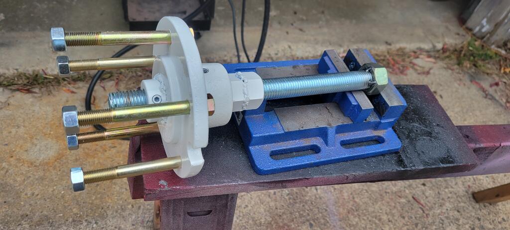

OldWorkHorse 3,129 #23 Posted October 9, 2022 Not much of a update but I am in the process of tearing down the rolling chassis, and 1 of the tear downs is removing the rear hubs off the transmission. I personally havnt had to much issue in the past removing the ones I've needed too but now that I mention it I have a feeling I just might now. So I went ahead and built my 1st wheel horse specific tool and made myself a hub puller! 3 Share this post Link to post Share on other sites

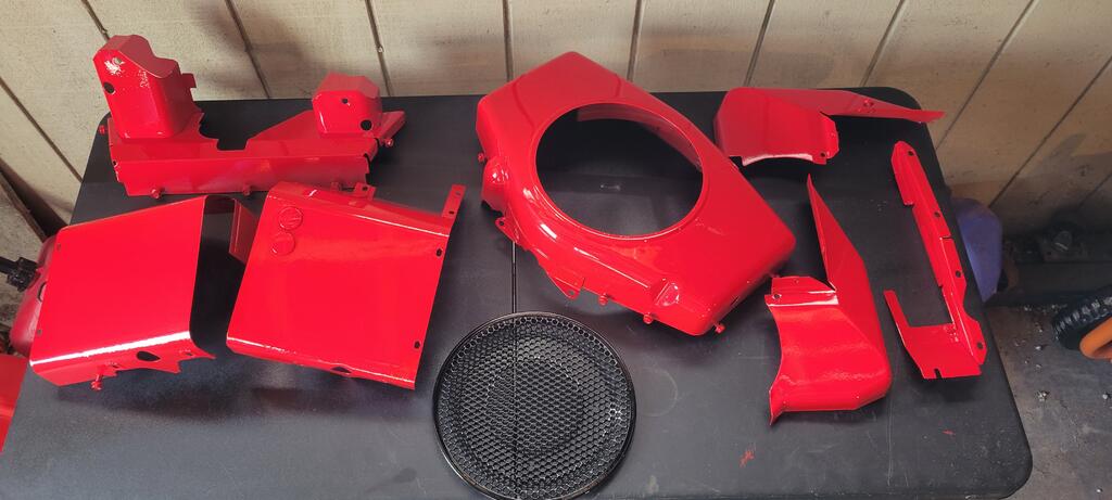

OldWorkHorse 3,129 #24 Posted March 2, 2023 (edited) So not much has happend on the 7317 last few months, took the kt17 down to @ebinmaine and went over that and bench tested it. Fired right up so that's good news. Hadnt been able to get back down there and pick it back up till i healed from surgery then once i did winter set in so been slow going. But its back and started to get it cleaned and painted, also stockpiling the parts going to need to put it all together. Edited March 2, 2023 by OldWorkHorse 7 Share this post Link to post Share on other sites
