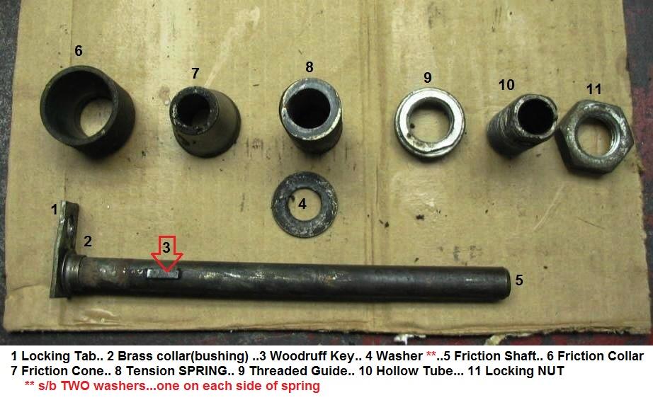

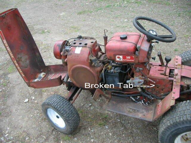

daveoman1966 3,768 #4 Posted October 6, 2022 I have rebuilt a few dozen Sundstrand power units. Yours would be model 90-1136 which is nearly identical to the 3 or 4 Sundstrand '90-xxxx' series. Internal components are virtually identical. DIAGNOSES; (1) change oil and filter. Take EXTREME care to wipe off ALL surfaces in doing the oil change & filter. The slightest particle of debris can tear up the brass internals of the Hyd pump and Hyd Motor. (2) There are 2 accelleration valves on the Hyd Motor section. Before refilling oil, remove both of these valves... (front and rear of the Hyd Motor). Inspect for faulty O-rings or stuck passages. (3) With any luck, you'll be able to open the Tow Valve. If so, work it back & forth to (maybe) reseat the valve tip. (4) The motion control linkage MAY be worn to the point of retirment... OR... there is a broken weld on the TAB of the motion control shaft (left side of Hoodstand). VERY COMMON, but removing / repairing / refab can be daunting. 2 3 Share this post Link to post Share on other sites
