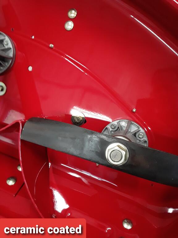

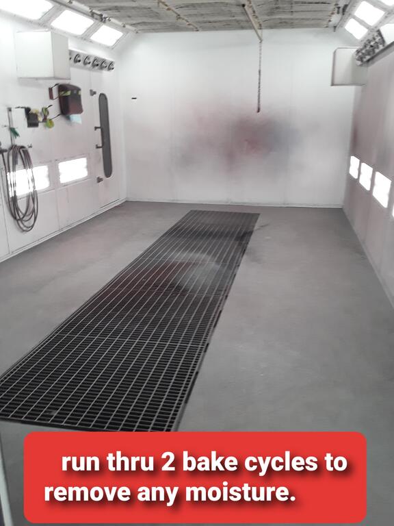

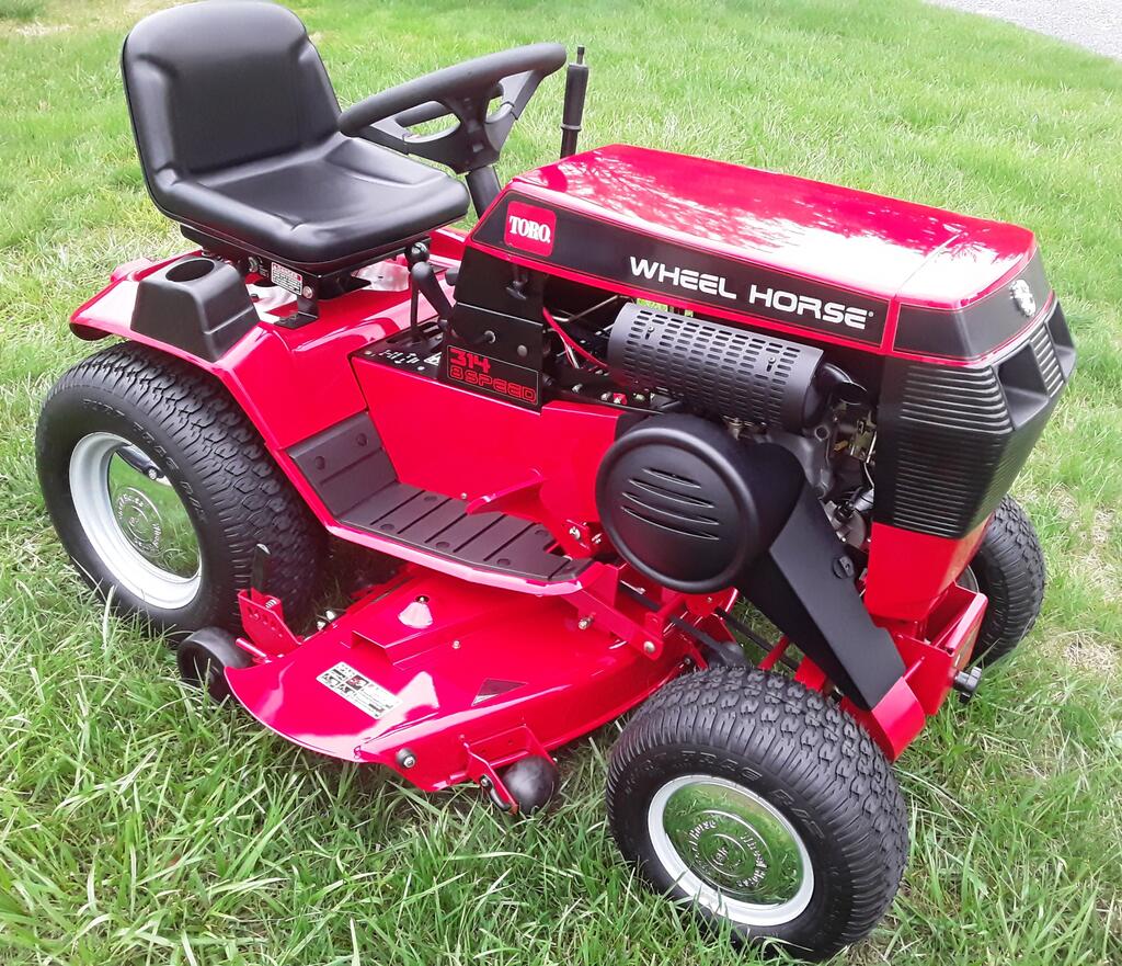

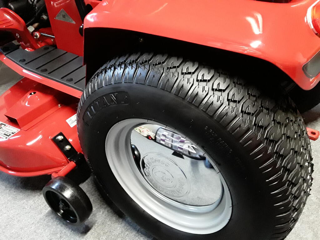

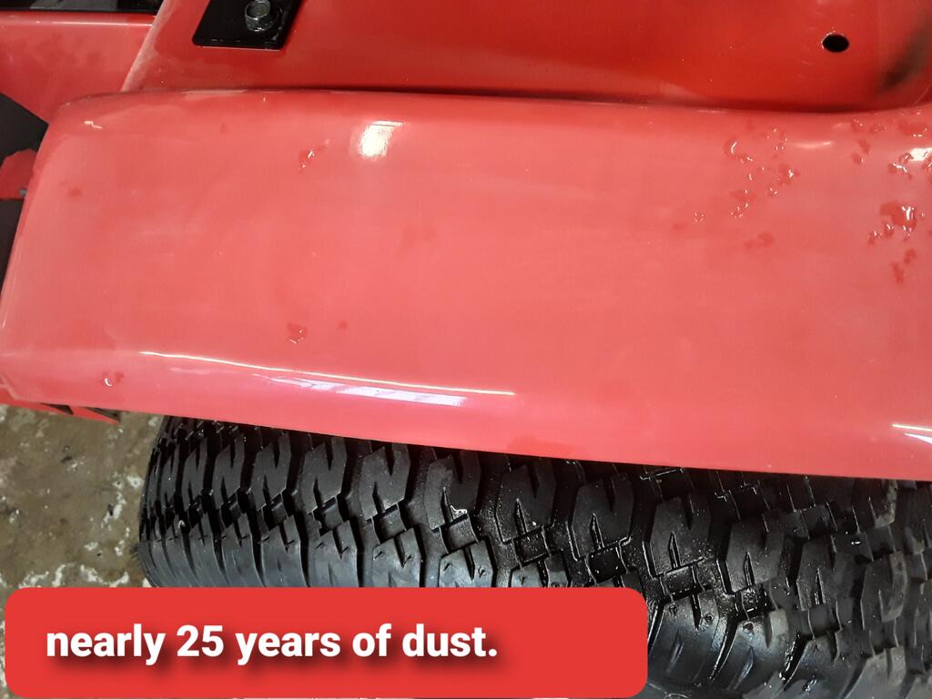

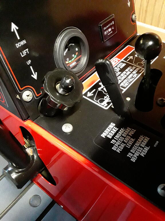

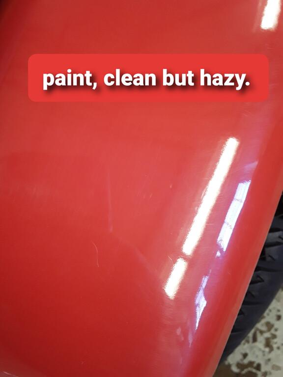

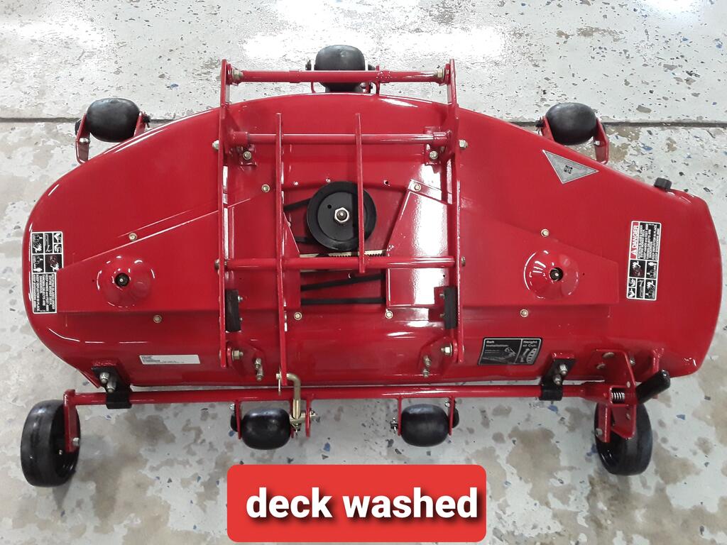

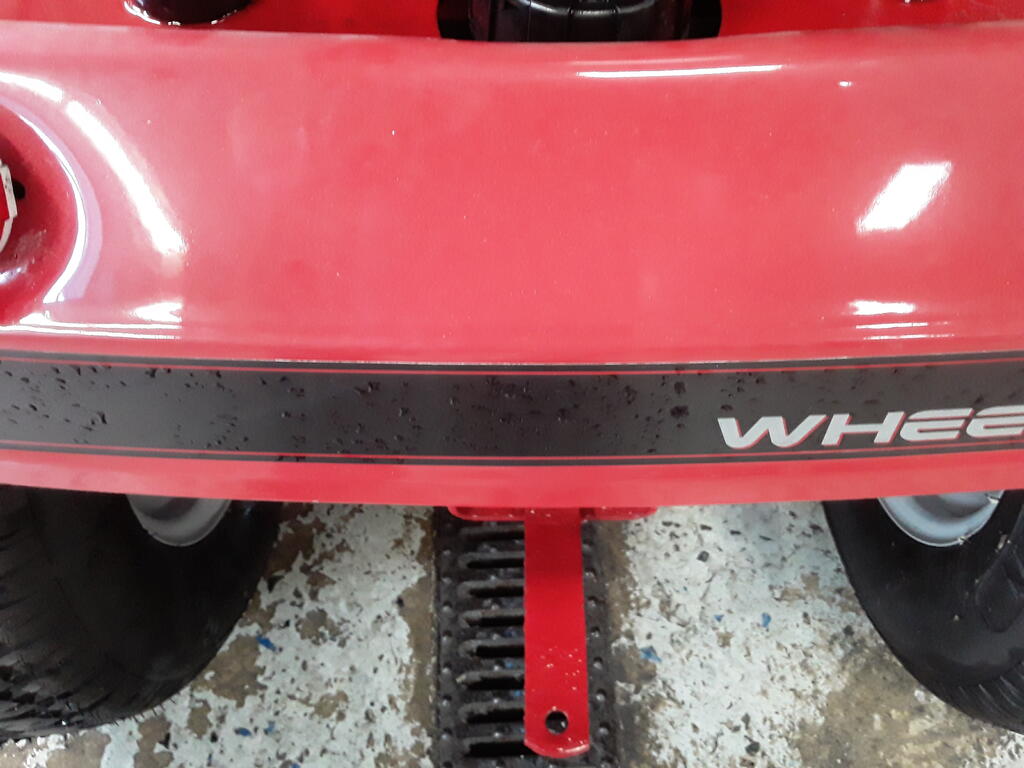

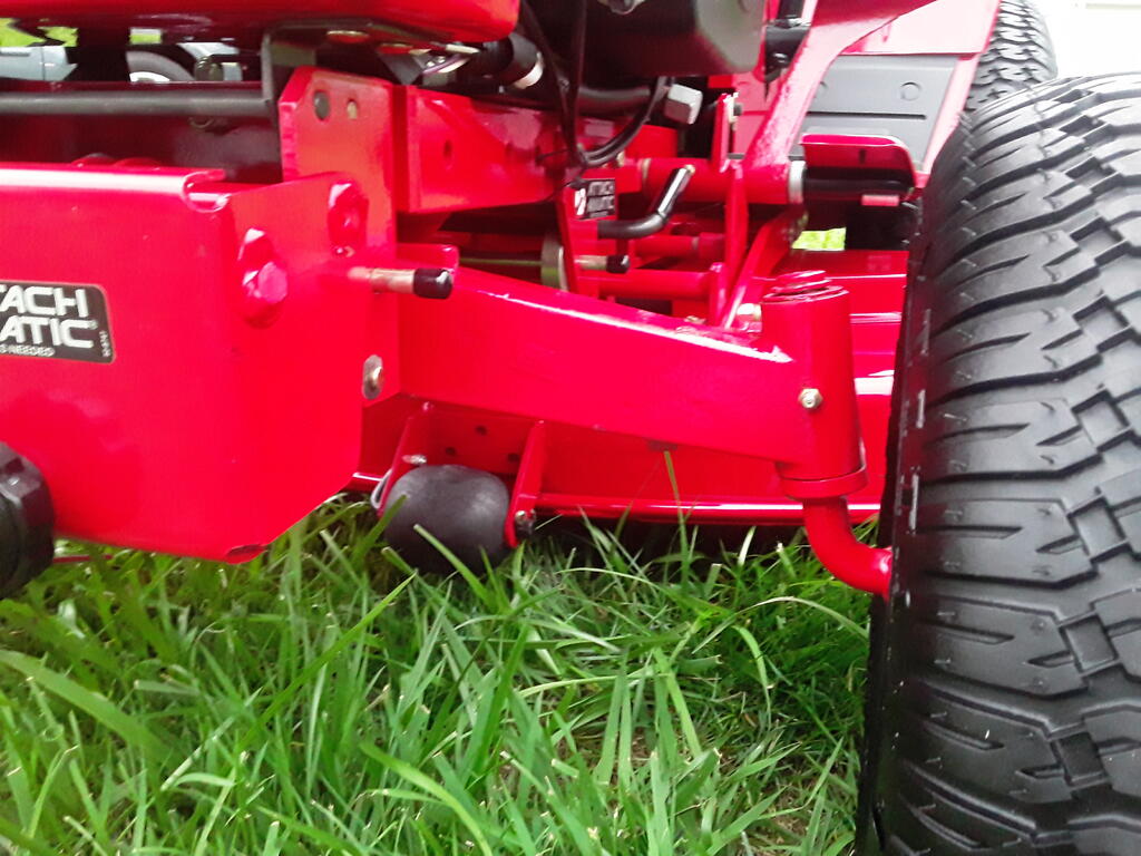

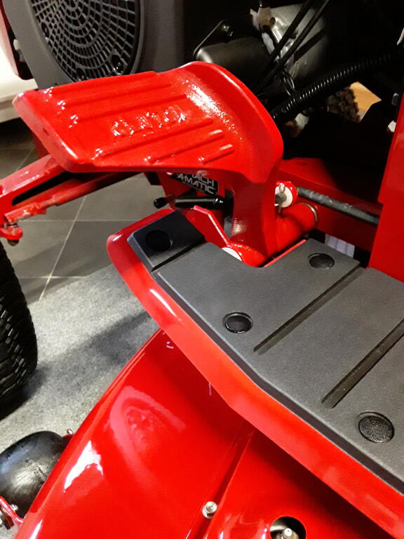

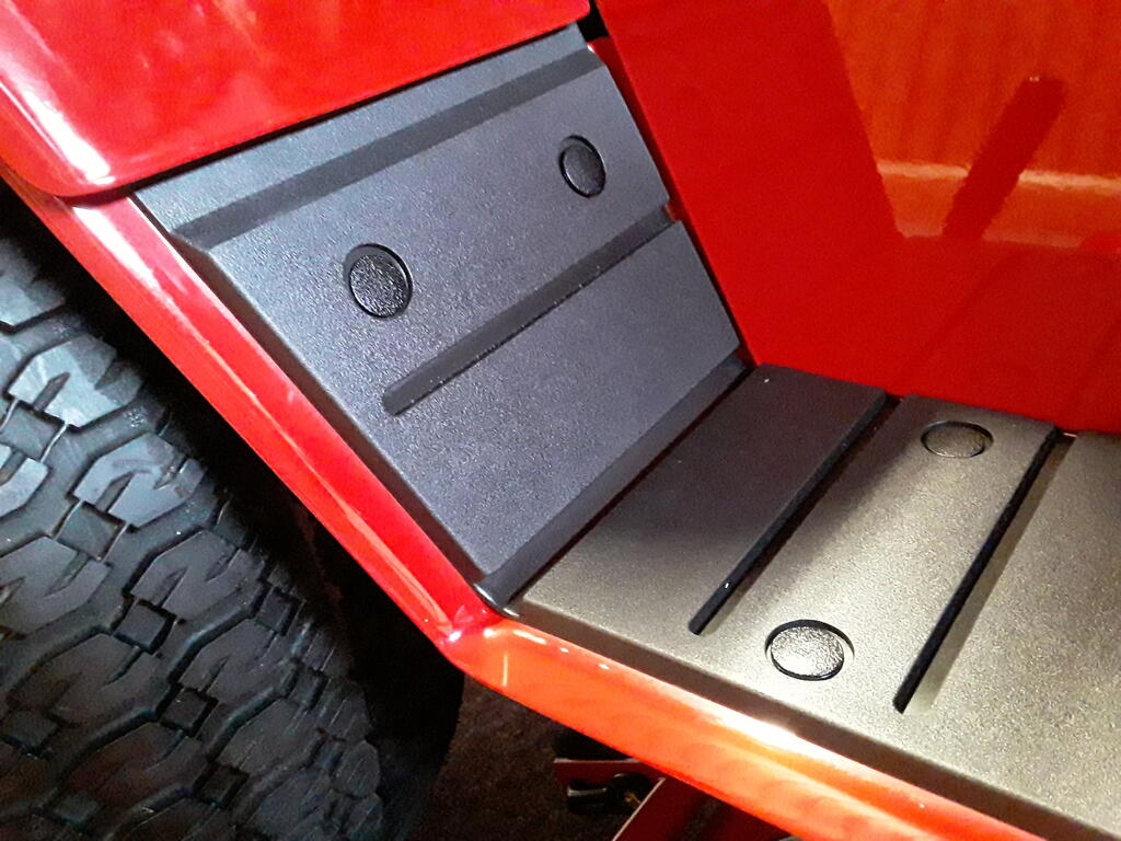

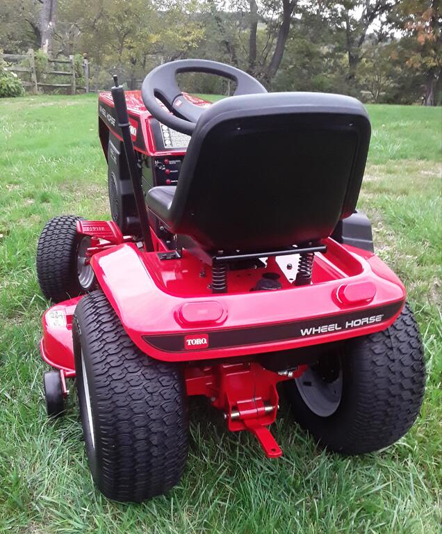

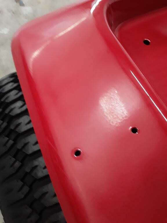

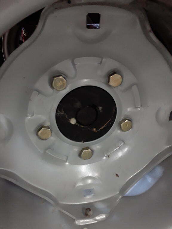

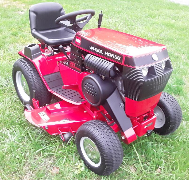

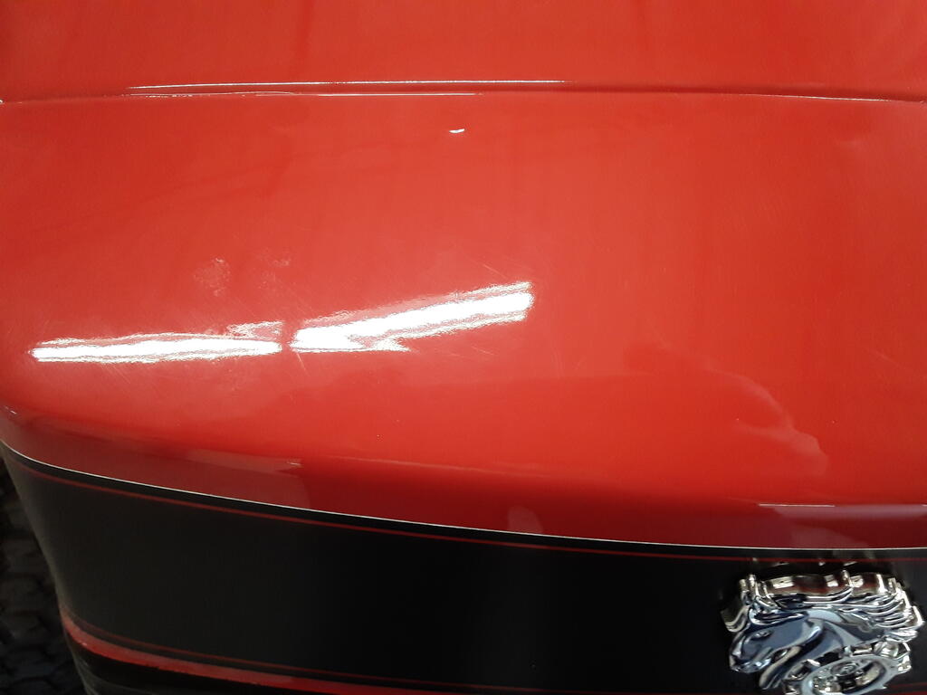

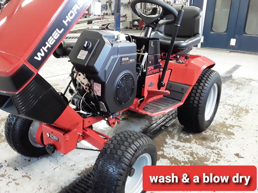

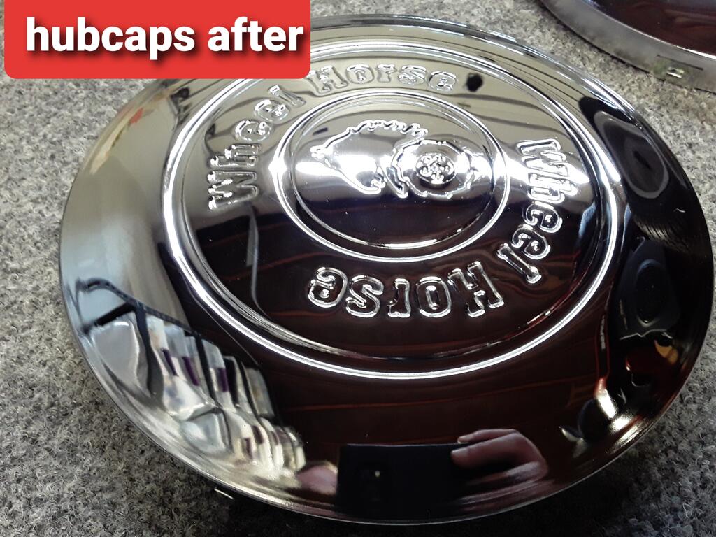

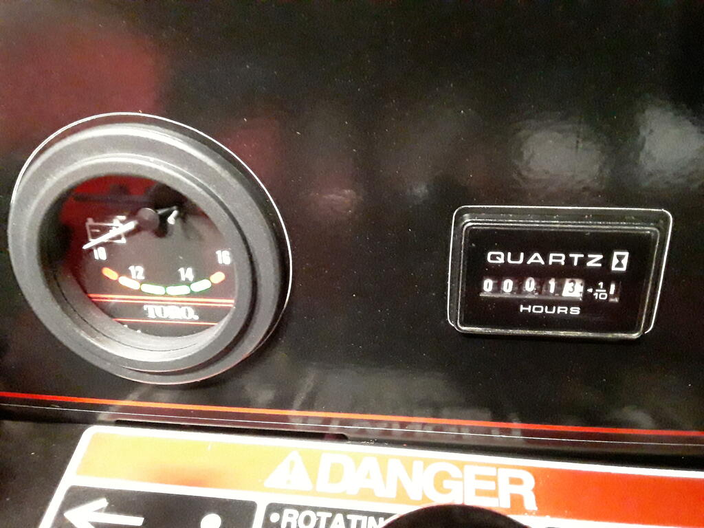

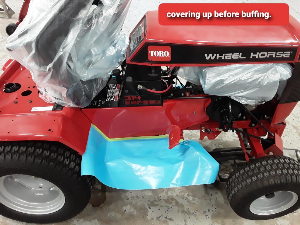

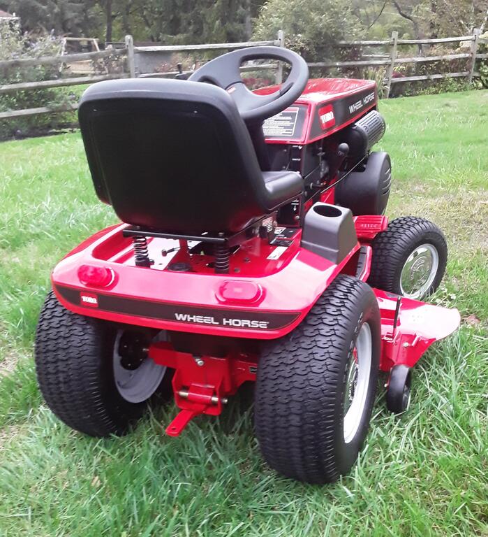

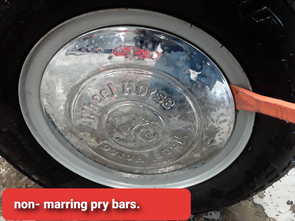

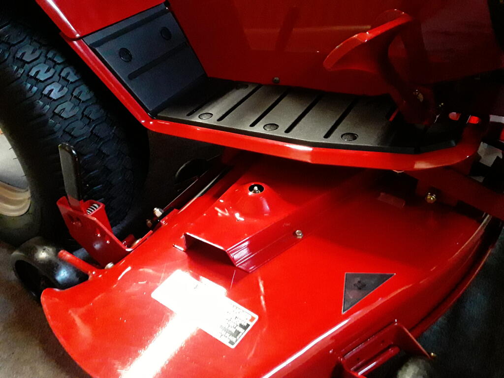

76c12091520h 3,689 #1 Posted October 4, 2022 Spent a rainy Saturday putting our newly acquired NOS 314 back into showroom condition after 20+ years of un-covered indoor storage. Took it to the shop , carefully removed a few pieces & gave it a thorough soap and water bath, followed by a blow dry and 2 bake cycles in the booth to remove any hidden moisture. Even though it was stored indoors, time and dust had made the finish less than pristine , so some corrective measures were needed. A light color sanding and buffing brought the finish back, followed by a complete ceramic coating. PTO assembly was removed and re-greased, along with a cleaning of the clutch mating surfaces. All the wire connections (plugs) were cleaned and re-greased as needed, oil was changed, gear oil changed, cup holder was installed. Deck chute and battery are here too ( not shown ) . Now it looks like a new machine should. 5 27 6 Share this post Link to post Share on other sites

23 Reo 229 #20 Posted October 10, 2022 Although my Horses are well worked and not shiny your tractor is too nice to use. It belongs in a museum. The only thing I would do is run it 1/10 of an hour. The number 13 makes me uneasy. 1 1 Share this post Link to post Share on other sites
