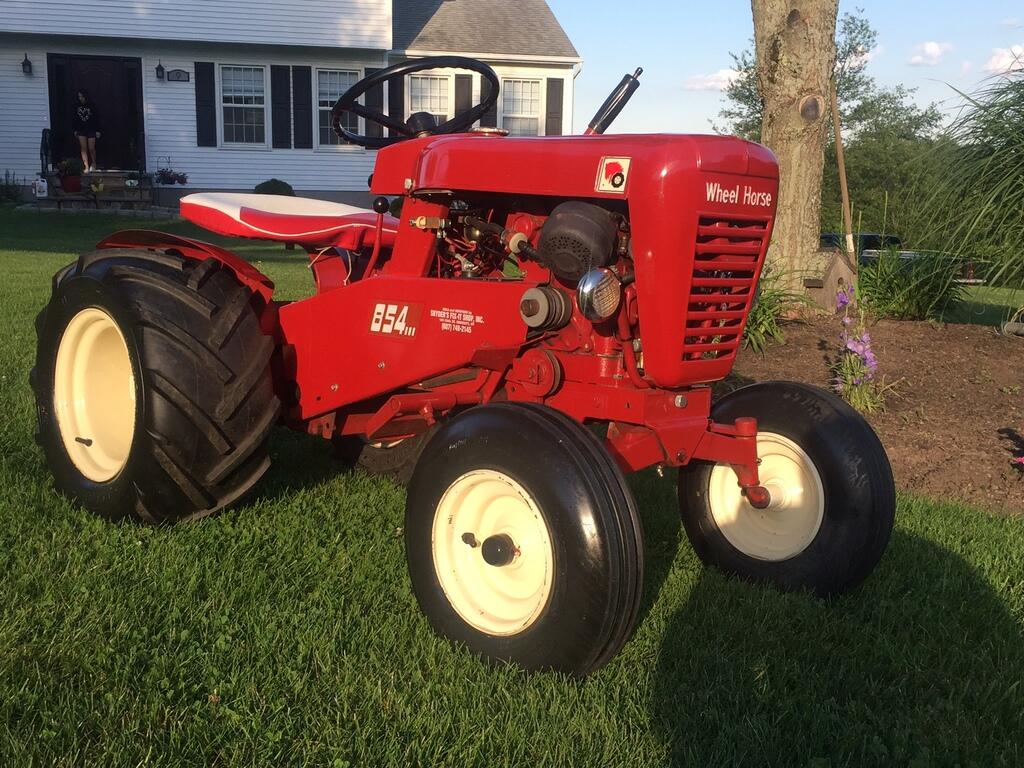

DBlackston 298 #1 Posted October 3, 2022 I have seen several pictures of 854s with wide tires but have not seen information regarding what wheels and tires they are running. I'd like to keep my eyes out for a set. Can anyone identify this wheel/tire combo and sizes? Share this post Link to post Share on other sites

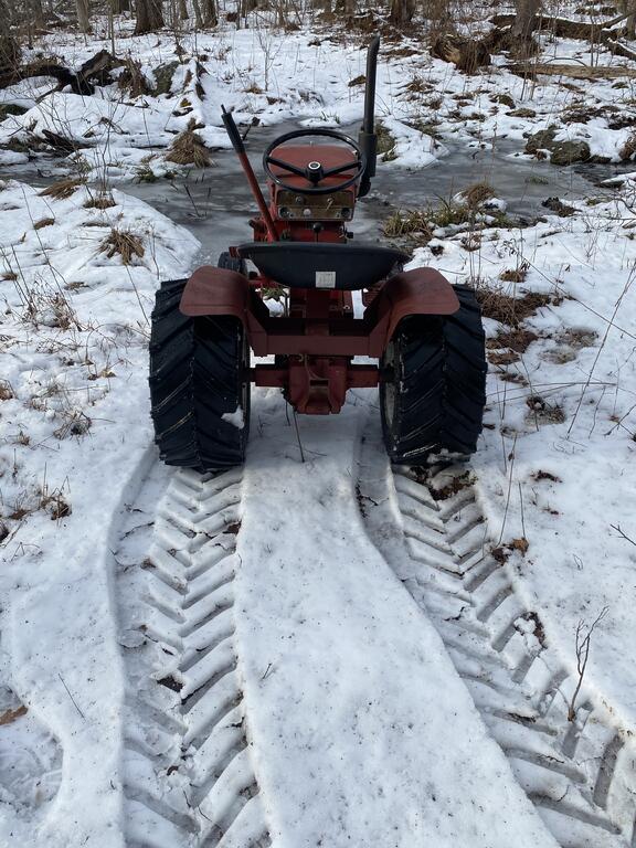

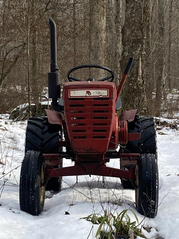

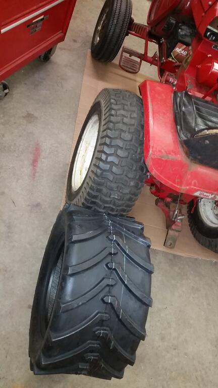

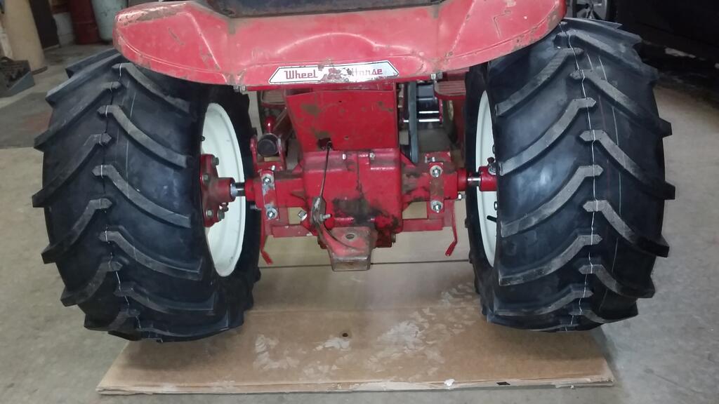

Sparky-(Admin) 22,034 #2 Posted October 3, 2022 Those look like 23x10.5x12 tires on 8.5” wide rims. These pics are mine. Tires are Carlisle Tru-Power 23x10.5x12 on 8.5” wide rims 5 Share this post Link to post Share on other sites

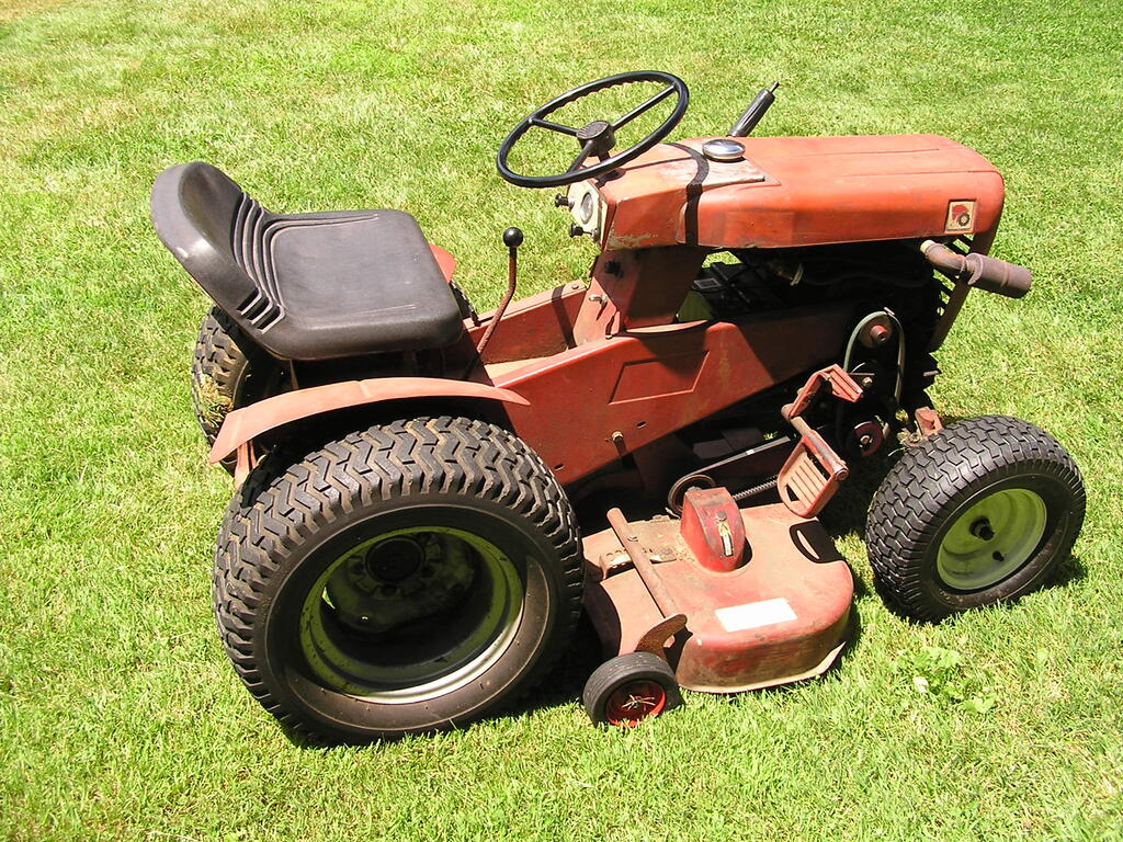

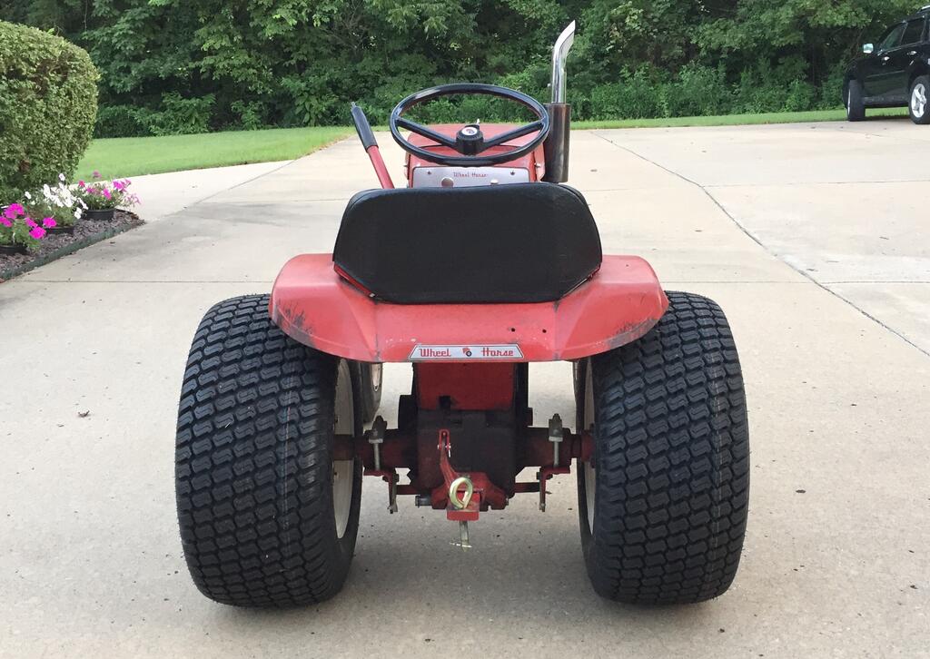

ri702bill 8,951 #4 Posted October 3, 2022 A wide set of Armstrong turf tires on wider rims, added to Dad's 702. 1 Share this post Link to post Share on other sites

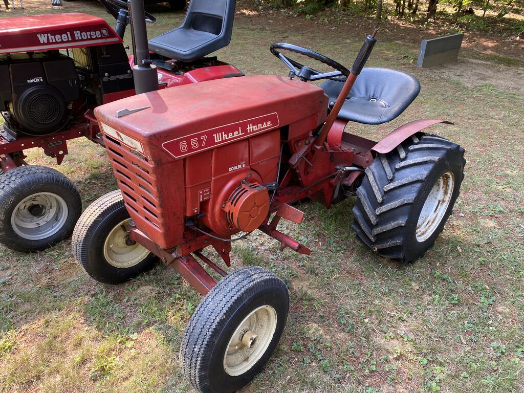

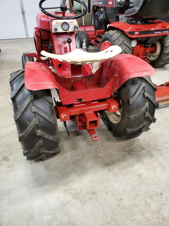

Moparfanforever 874 #8 Posted October 3, 2022 This is my 702 with 8.50 Tru Powers. Not sure what the rims come off of, but they have a deeper offset than a WH wheel. The cost of tires for these tractors has gotten stupid expensive. I was going to buy four 10.50 Tru Powers, but they were going to cost around $600. I may just have to start putting tubes in my cracked turf tires 3 Share this post Link to post Share on other sites

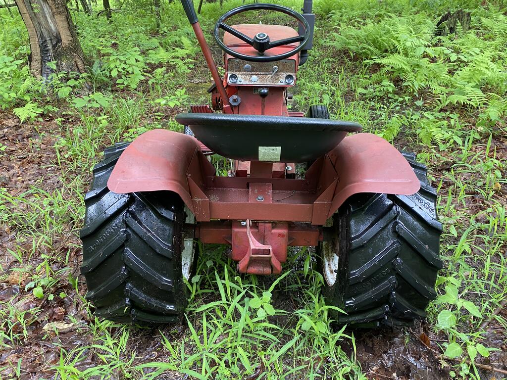

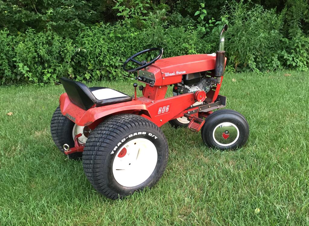

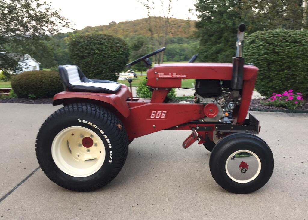

cschannuth 3,817 #11 Posted October 6, 2022 On 10/2/2022 at 10:50 PM, DBlackston said: I have seen several pictures of 854s with wide tires but have not seen information regarding what wheels and tires they are running. I'd like to keep my eyes out for a set. Can anyone identify this wheel/tire combo and sizes? I have a set that are pictured on the back of my 606 if you’re interested. I will be going through Kansas City up to Weston, Missouri tomorrow afternoon and coming back home Saturday morning to mid Missouri if you want to meet me somewhere along the way. They are 520 wheels by the way. 2 Share this post Link to post Share on other sites

DBlackston 298 #14 Posted October 7, 2022 8 hours ago, cschannuth said: I have a set that are pictured on the back of my 606 if you’re interested. I will be going through Kansas City up to Weston, Missouri tomorrow afternoon and coming back home Saturday morning to mid Missouri if you want to meet me somewhere along the way. Thanks man! I actually have all the wheels and tires I need currently to finish my 3 tractors I have. I am just window shopping for the next one right now! Share this post Link to post Share on other sites
cschannuth 3,817 #15 Posted October 7, 2022 8 hours ago, DBlackston said: Thanks man! I actually have all the wheels and tires I need currently to finish my 3 tractors I have. I am just window shopping for the next one right now! No problem. I have an extra set for the back of that 606 that are wide so if you ever need some just let me know and we’ll figure something out. Share this post Link to post Share on other sites
