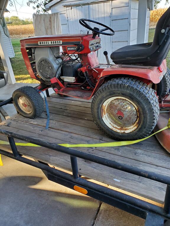

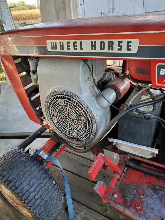

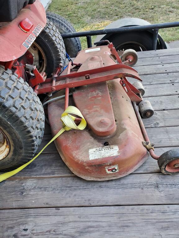

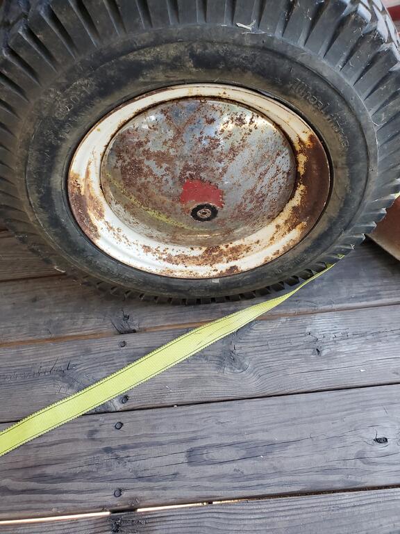

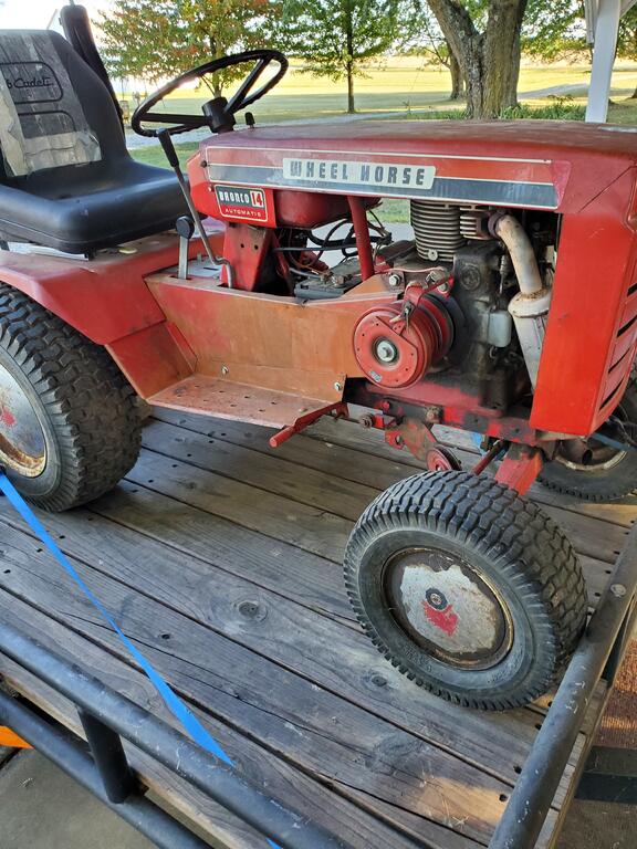

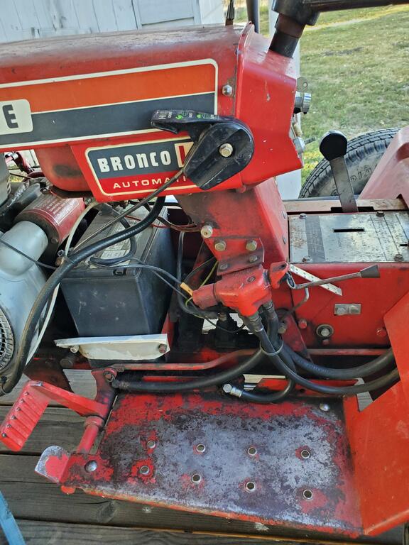

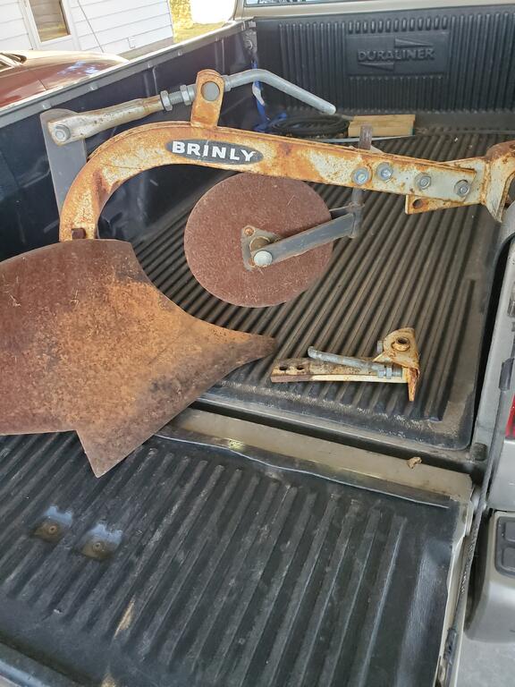

Moparfanforever 874 #1 Posted October 2, 2022 This Bronco 14 was listed on MP, about a 75 mile round trip, all for $100. The owner was cleaning his place up and wanted it gone and I seen it at the right time. It does have some PO mods and it is pretty greasy around the lift and engine. I haven't heard it run,but the owner says it runs good,we will see. I will work on it tomorrow and see. The horsey hub caps are crusty and it has a replacement engine. The Cub Cadet seat is adjustable!! 10 18 4 Share this post Link to post Share on other sites

Moparfanforever 874 #6 Posted October 3, 2022 (edited) The Kohler engine sticker has K321 on it, all I can go by. The last four tractors I have brought home has had Walbro carbs on them. Edited October 3, 2022 by Moparfanforever 2 Share this post Link to post Share on other sites
ebinmaine 70,789 #7 Posted October 3, 2022 1 minute ago, Moparfanforever said: The Kohler engine sticker has K321 on it, all I can go by. The last four tractors I have brought home has had to Walbro carbs on them. Likely an 80s or newer engine just guessing by appearance. Walbro may have been Standard on them... (?) 2 Share this post Link to post Share on other sites

EB-80/8inPA 1,794 #10 Posted October 3, 2022 It looks like you got a good deal on a plow for $100, with a free tractor and mowing deck. Well done! 2 1 Share this post Link to post Share on other sites
Pullstart 64,593 #11 Posted October 3, 2022 Great deal on a plow and free tractor! Share this post Link to post Share on other sites
OutdoorEnvy 1,733 #12 Posted October 3, 2022 Shoot it's even got an original slot hitch on it AND a separate slot hitch to sleeve hitch adapter for the plow. Excellent score! That's why it pays to keep an eye out just to see what pops up for sale. 1 Share this post Link to post Share on other sites

kpinnc 13,750 #16 Posted October 6, 2022 Likely a standard replacement engine. Many of the old Kohlers came in that gray if they were bought direct from Kohler. Thinking it's a 1972? Or the ignition has been converted to points and coil. 1971 used Kohler's first attempt at magneto ignition. Works fine, but hard to find and expensive to replace ignition modules. 2 Share this post Link to post Share on other sites

Moparfanforever 874 #18 Posted October 6, 2022 2 hours ago, kpinnc said: Likely a standard replacement engine. Many of the old Kohlers came in that gray if they were bought direct from Kohler. Thinking it's a 1972? Or the ignition has been converted to points and coil. 1971 used Kohler's first attempt at magneto ignition. Works fine, but hard to find and expensive to replace ignition modules. It has been rewired, could have had the mag ignition?? It has the push/pull cables, 1971?? The cigarette lighter even works and works really well !! I think it is OG. Not sure if I will mess with it this winter,the hydraulic lift has a small leak, I think the orings behind the cam plate are leaking, and worst of all, it needs an axle bearing. To much up/down movement. Never been into a hydrostatic before, have to do some readin' on that. Three tractors are ahead of it to get worked on, so maybe next spring. I am old and slow, but maybe I can start taking some Tylenol of a morning for the aches and rip right through them!! VROOM, VROOM !! 2 Share this post Link to post Share on other sites
kpinnc 13,750 #19 Posted October 6, 2022 (edited) 2 hours ago, ebinmaine said: 1970. I had a 1970 Charger Hydra with that. You're correct. I was speaking only about Broncos. I should've clarified that. 18 minutes ago, Moparfanforever said: It has been rewired, could have had the mag ignition?? It has the push/pull cables, 1971?? I think only the 71 model Broncos had the mag ignition. Seems like the 72s went back to battery ignition. Only way to be sure is gonna be the model number tag. Edited October 6, 2022 by kpinnc 1 Share this post Link to post Share on other sites

Retired Wrencher 5,650 #24 Posted October 8, 2022 Mopar, I think those moons will shine up nicely with chrome polish. In time the rest will fall into place. May be paint the engine in the spring if you want to. Enjoy the project. 1 Share this post Link to post Share on other sites
953 nut 57,980 #25 Posted October 8, 2022 On 10/6/2022 at 6:10 PM, Moparfanforever said: It has been rewired, could have had the mag ignition?? It has the push/pull cables, 1971?? It would have had the trigger ignition going out of the factory, wiring is the same as a magneto. If the wiring from the previous owner is working well just clean up any corrosion and tighter all connections and you should be god to go. The cigarette lighter even works and works really well !! I think it is OG. OG ? I'm not understanding that lingo. Not sure if I will mess with it this winter,the hydraulic lift has a small leak, I think the orings behind the cam plate are leaking, and worst of all, it needs an axle bearing. To much up/down movement. Never been into a hydrostatic before, have to do some readin' on that. The hardest part of repairing the axle bearing is removing the hubs, hitch pin and the sheet metal. Read some of the Sundstrand posts from @daveoman1966 and others and you will be fine. Pressure wash the entire transaxle before you begin working on it, cleanliness is a key to success. Three are ahead of it to get worked on, so maybe next spring. I am old and slow, but maybe I can start taking some Tylenol of a morning for the aches and rip right through them!! I resemble that remark! VROOM, VROOM !! 1 Share this post Link to post Share on other sites
