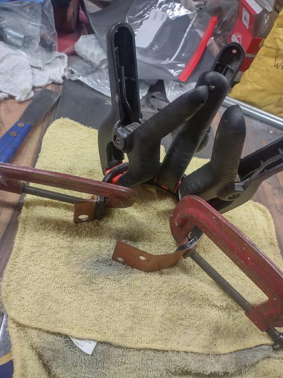

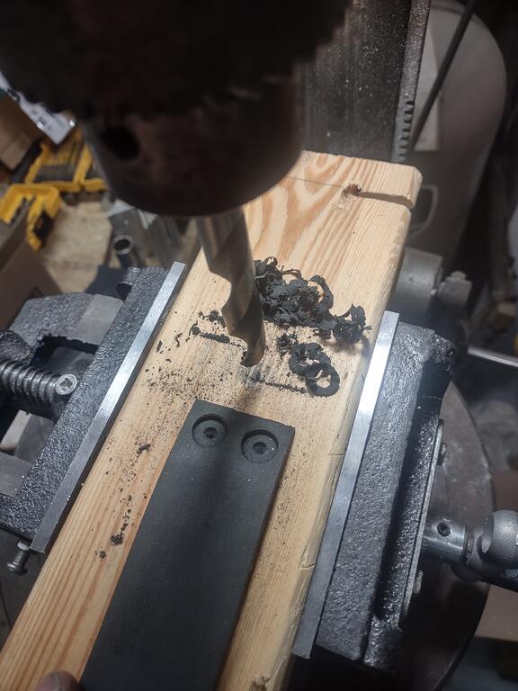

ebinmaine 70,688 #20 Posted September 27, 2022 4 hours ago, elcamino/wheelhorse said: Found some paper work on a brake liner I bought from Bob many years ago . I just found the liner in the shed from heck. Bob recommend Permatex 80050 clear rtv silicone adhesive First of all... Thanks to all posters above for some great information. I got to poking around the basement workshop and found some of the exact recommended product. I consulted the BBT who generally has a mind like a steel trap. Her memory is startlingly excellent. Neither of us remembered taking a lot of time cleaning up the band or shoe when I installed it originally and I'm QUITE sure I did not use the recommended 80050 on the first application. A comment above by @Rick3478 got me looking online a little more. Rick mentioned that because I used silly-cone the first time that's what I may have to stick with. Other info on the interwebs and my own past experience agrees with that. So... Given that it's VERY likely my own fault for not doing proper prep and.... not wanting to use another piece of brake lining I decided to do a good strong clean up and reuse the existing shoe. I removed the tires and got to the brake band. Popped that off and commenced to cleaneration and modification. I used coarse paper to scuff the surface of both band and shoe, then a finer paper to even and smooth the surface of both as per a thought induced by @wallfish : 13 minutes ago, wallfish said: or if a small portion of the band is constantly touching the drum I found one spot worn more than the rest. After that I dug into the rivet holes a little with a wood bit on my drill press. I cleaned the band and shoe extensively with acetone because that's what I had here. Wiping the metal band until it was clean was fairly easy. The shoe took a fair amount more work... But it's good. Nice even coat of PE 80050 and some clamps. And we wait. I'll install it when I get a minute.............. 2 Share this post Link to post Share on other sites

wallfish 17,485 #22 Posted September 27, 2022 1 hour ago, ebinmaine said: I used coarse paper to scuff the surface of both band and shoe, then a finer paper to even and smooth the surface of both as per a thought induced by @wallfis I wouldn't smooth gluing surfaces. Rough surface is better for gluing/adhesion. You should be good though. Next one you can clamp the band tight around the drum. That will put pressure on the the entire thing. You can install it over the drum and use a strap on the pedal to clamp it too 3 Share this post Link to post Share on other sites
ebinmaine 70,688 #23 Posted September 27, 2022 17 minutes ago, wallfish said: I wouldn't smooth gluing surfaces. Rough surface is better for gluing/adhesion. You should be good though. Next one you can clamp the band tight around the drum. That will put pressure on the the entire thing. You can install it over the drum and use a strap on the pedal to clamp it too I should clarify "fine". It was 120 grit. I did ((kinda)) use the drum and brake band as a clamp ... Sort of. I've installed it and set the park brake on a hard hold for the night. 2 Share this post Link to post Share on other sites
