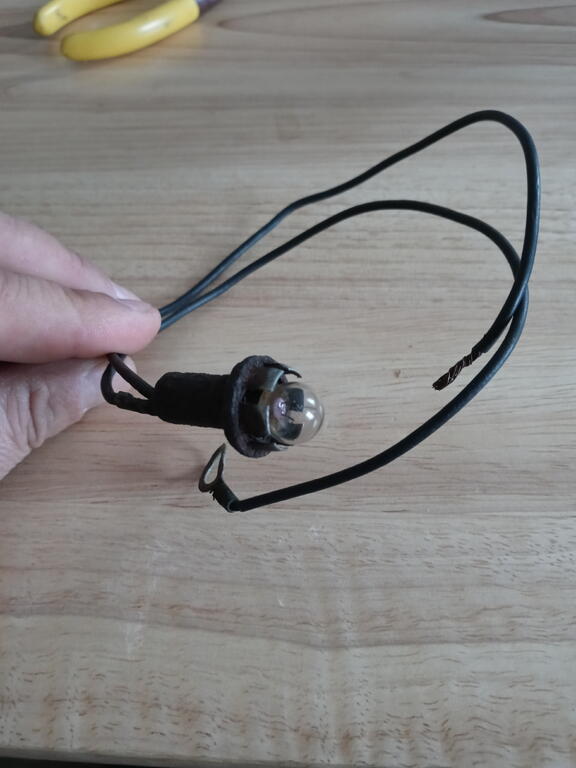

marreque 214 #71 Posted November 27, 2022 Came up on a box of parts today. Had the factory throttle lever in it with the white knob and what I believe may be the Gen light... 3 Share this post Link to post Share on other sites
953 nut 57,904 #72 Posted November 27, 2022 1 hour ago, marreque said: I believe may be the Gen light. That is your generator light, large terminal goes to the starter button on the post that feeds the S/G "A" post , the other wire goes to the key switch post that goes to the ignition coil. 2 Share this post Link to post Share on other sites
marreque 214 #73 Posted November 27, 2022 Thank you, will be needing a new bulb...#53 is what's in it now. 1 Share this post Link to post Share on other sites
