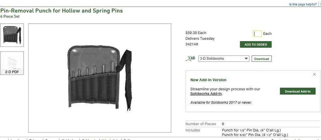

pfrederi 18,323 #8 Posted September 24, 2022 Mcmaster 3 Share this post Link to post Share on other sites

pfrederi 18,323 #12 Posted September 24, 2022 The seat I got from McMaster was Mayhew made in USA good thing about McMaster you can by individual replacements if needed.. (Seriously bent a 1/8 once. 4 Share this post Link to post Share on other sites
