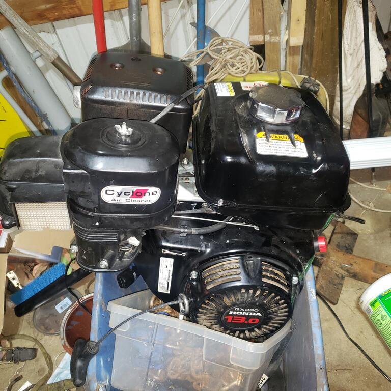

cerial 7 #1 Posted September 22, 2022 I picked up a engine yesterday to replace a worn briggs in my 78 c-161. It is a honda that was in a stump grinder. Just going to keep things simple with this. The thing has a pto on it and I was wondering if I could use it or would be better off using the one on the briggs. I know little to nothing about lawnmower pto's so any guidance is appreciated. Share this post Link to post Share on other sites

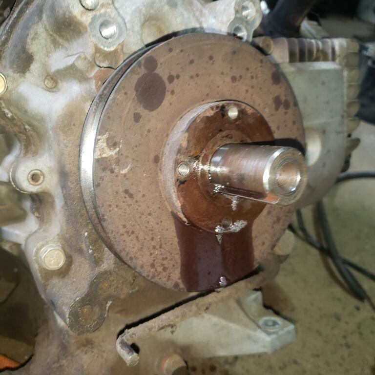

cerial 7 #4 Posted September 22, 2022 I only paid a few hundred for the engine to just get this old girl moving again as a backup snowblower/lawnmower. If I get 30 or 40 hours of run time out of it I will be happy. The clutch has a plate at the side and I dont know if that plate has to be pushed in, or if the outside needs to be dragged a bit to engauge cogs to lock in place, or something else. The guy said the clutch was newer so if I can use it then I would like to. If not then I need an idea on how to remove it properly to install the wheelhorse one. If the shafts are slightly diffrent I am sure I can find a way to adapt (weld) something and make it work. But before I go through all that fun lets see if I can use the clutch thats on it. Share this post Link to post Share on other sites

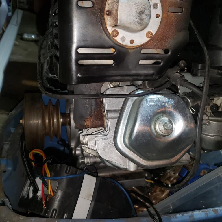

cerial 7 #8 Posted September 25, 2022 (edited) Briggs is on the shop floor, engine bay is all cleaned up, the centrifugal clutch is pulled off the Honda, and I have the clutch removed to the briggs up to this point. Letting that soak for a little bit before I put a 3 jaw puller on this. The pulley just pulls off and presses on right? It would suck if I bent this thing because I did not do something simple. Before I do that I thought I would ask what I am hoping is a stupid question. Plan is to just measure before pulling off the pulley then match that measurement on the Hondas shaft when installing the pulley. Edited September 25, 2022 by cerial Share this post Link to post Share on other sites

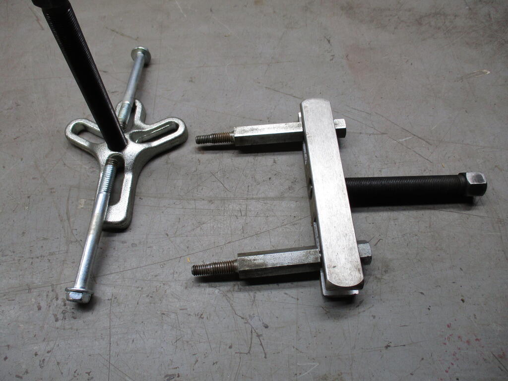

pfrederi 18,073 #9 Posted September 25, 2022 I would not use a three jaw puller. You may damage the pulley. Use the threaded holes and timing gear type puller There should be a set screw in the pulley aligned with the keyway 1 Share this post Link to post Share on other sites
cerial 7 #10 Posted September 28, 2022 Few things to button up still. But the old girl now moves. Share this post Link to post Share on other sites
