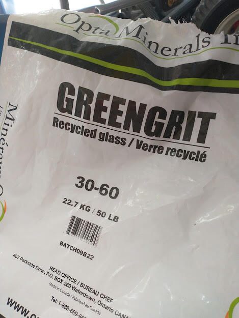

rmaynard 15,927 #3 Posted September 14, 2022 I have a Harbor Freight floor-type blaster cabinet that I have made extensive modifications to. I use glass beads. They are marked 30-60, but I'm not sure how it compares in size to the TSC Black Diamond fine coal slag which I find quite coarse. These glass beads seem to work well on everything and it's cheap. Again, successful blasting depends on many things, pressure, volume, tip size, etc. What you are blasting is important. Soft paint is harder to remove than hard paint. 2 Share this post Link to post Share on other sites
