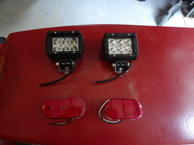

1 hour ago, Snoopy11 said:
Those even look similar to the reflectors that I put on it!!! WOOOHOOO!  B)
I bought them! :banana-wrench:
Don
Those look like the ones I got for the 125, except mine have black bases...
I think I sent ya pics of that at one time?  Here's one again...  the toggle switch ahead of the seat switch is for the rear flood. (also LED)

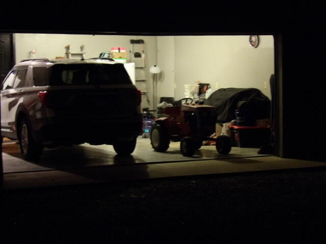

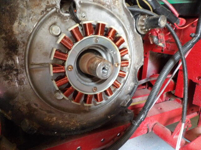

Tractor got pulled back into the garage last night. I seriously doubt that I am going to get the golf cart fixed before my next machine shows up next weekend... so to make room... I will probably keep the 416-8 in the garage for a while. :ph34r:
IN THE DARK DARK... :music-rockout:
LET. THERE. BE. LIGHTS!!! And some... BOOM SHACKA LACKA, SHACKA LACKA, SHACKA LACKA... :banana-dance:

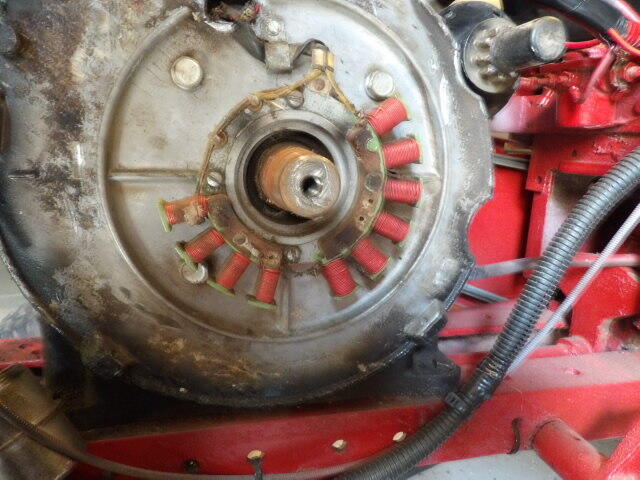

Old...
100_2143.JPG.3f59fb42b1d66eb757617b1eb45e2202.JPGe

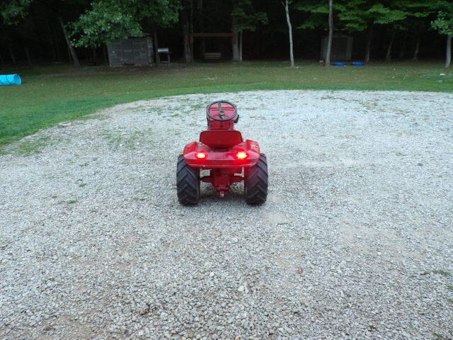

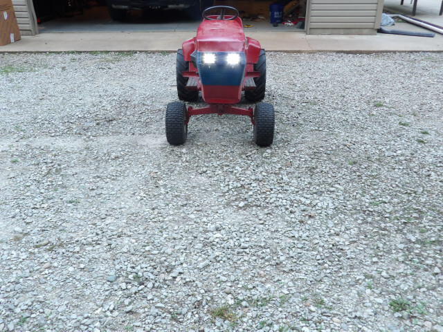

New...
Rear:
Front:

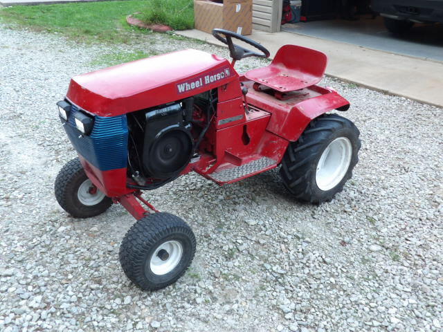

Side (see if you can find where I put the regulator in this picture):
I'm satisfied. My main gripe with IST... is that NO hardware is included... so... the little screws that hold on the stock stator do not work. Luckily I am a screw hoarder... :P

ineedanother
Looks great Don. Regulator on the frame :thumbs: I like it.
Snoopy11
You win the prize! :banana-dance:

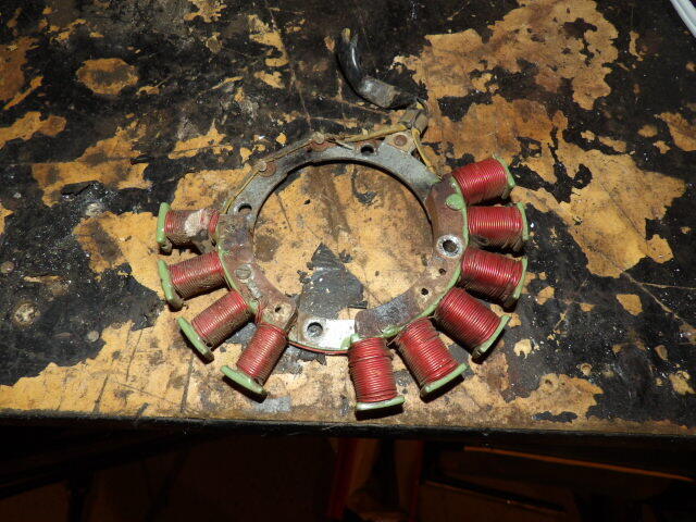

The old stator! :laughing-rofl:
I can ship to your home... or whatever address you desire (including your local landfill)... :hide:
