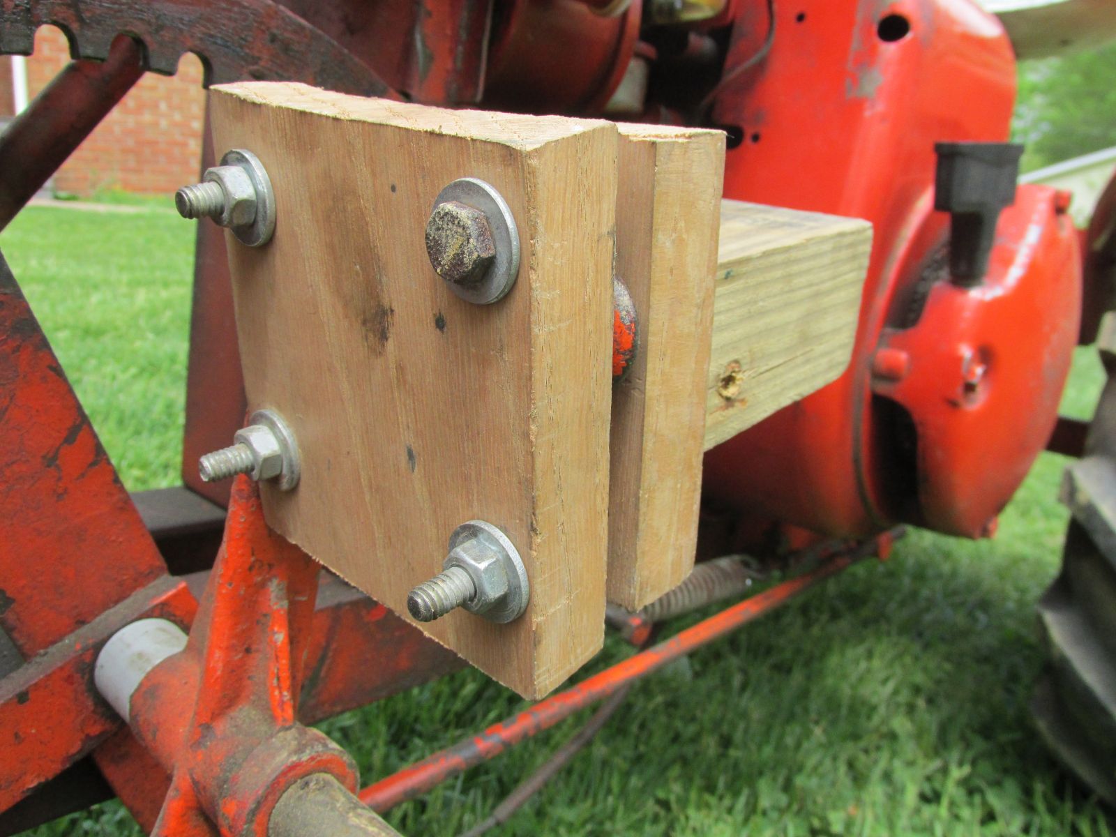

Wheel Horse Clutch Extension
This shows how I "sandwiched" the clutch pedal with two pieces of wood, one having a piece of a old stud screwed to it. Both pieces of wood have four bolts pinching it over the clutch pedal. The first time I built this I made the mistake of running the grain of the wood parallel to the clutch pedal, this caused the wood to brake. This time I ran the grain perpendicular to the clutch pedal, this made it a lot stronger.
