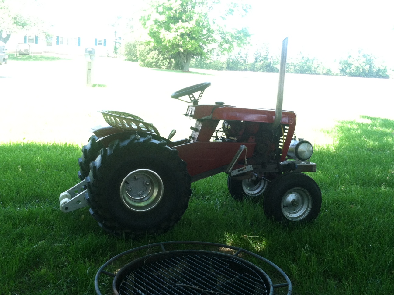

its a 1963 753 it is all original and a lot has been bolted on using existing holes the tank on the front is the fuel tank now because the original one wouldn't hold fuel and more. the hole the project took off from there. The wheelie bars are 1in solid aluminum with a hitch built in. It has been regeared and will run around 30 mph or maybe a little bit faster but I do have 3 different sets of gears and can make it do crazy wheelies the shifter has been cut and shortened. the rear tires are off a quad and have a custom build 6in spacer to make them fit. the tractor is getting painted international red soon and all the dents fixed. I started the project at 15 years old and took a pause on the build for 4 years for the military now its back on. the tractor was bought new by my great grandfather in 1963. its a fun tractor and I cant wait to show it off.
