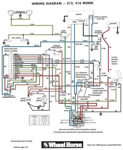

Tractor 1987 312 Wiring Detailed Rev.pdf
admin
3 Screenshots
Detailed wiring from the Demystification Guide #492-4509 Revised
5 pages 1.7MB Color pdf
Pages p7-33 to p7-37

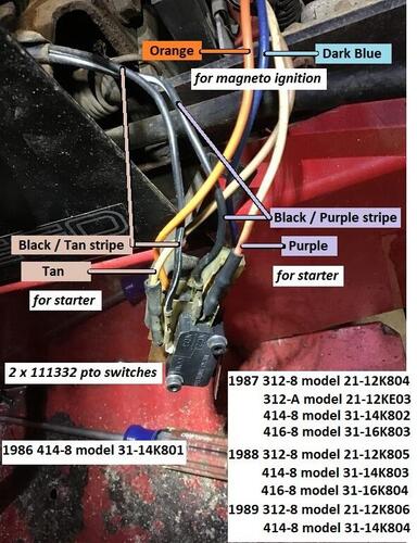

Pto switch wiring photo
1 page 211KB
Magneto ignition and 15 amp stator
Low oil switch
1987 312-8 model 21-12K804
1987 312-A model 21-12KE03
