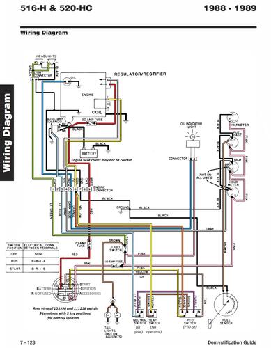

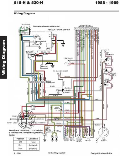

520-H Wiring Color pdf
1 page 583KB
520-HC Wiring Color pdf
1 page 418KB

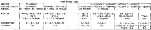

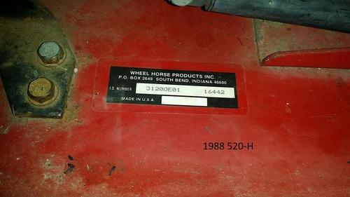

1988 520-H model 31-20OE01
1988 serial numbers that have shown up for the 31-20OE01
01201
08114
10025
10027
10111
10203
10314
10328
10330
10367
10445 - Build date 1987 7351 December 17 Thursday
10503
10590
10790
10809
1089x - x may be a 7
11021
11122
11159
11324
11384
11533
11658
11709
12022 - Build date 1988 8116 April 25 Monday
12082
12433
15021
15130
15426
15514
15571
15587
15683
15765 - Build date 1988 8284 October 10 Monday
15780
15787 - Build date 1988 8286 October 12 Wednesday
15817
15981
16016
16079
16157
16336
16504
16564
