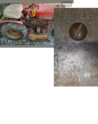

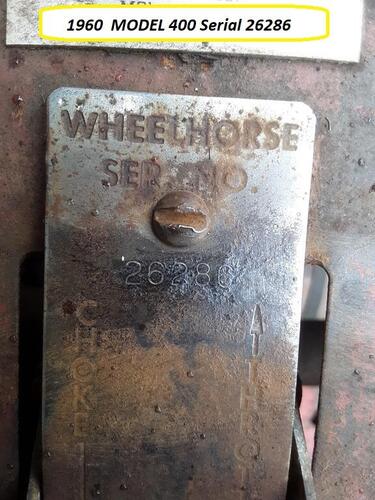

Serial number
1960 Suburban - Stamped into the metal throttle/choke plate just under the upper screw. (CasualObserver)

26286
