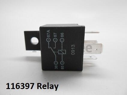

Relay Start 116397 List.jpg 1.0.0
2 Screenshots
116397 relay used 1989-1998 and replaces 116379 and 48-4700
116379 relay used 1992-1993 and most likely a typo for 116397
48-4700 relay used 1994-1998
106833 3-terminal relay replaced by a 5 terminal substitute in production because of a parts shortage.
These were replaced by SA121378 service assembly which was replaced by 99-5365 kit.
The 99-5365 kit contained a 48-4700 relay which has been replaced by 116397 relay.
116397 relay used on 1990 300-Series for the low oil starter circuit and 1990 200-Series, 400-Series and 500-Series as a starter relay.

116397 Start relay used on
1989 model Y1 -16OE01
1990 models 31 -10K801, 31 -12K801, 31 -12KE01, 31-16O802*400, 32 -10B501, 32 -10BE01, 32-12O501*200, 32-12OE01*200, 32-16BE01, 41-16OE01*400, 41-20O801*500, 41-20OE01*500, R1 -12K802, R1-16O802*300, R1-18OE02*500, Y1-12OE01*Z, Y1-16OE02*Z, Z1-24OE03*Z
1991 models 22-14O501*200, 22-14OE01*200, 31 -10K802, 31 -12K802, 31-16O803*400, 32-10B502*200, 32-10BE02*200, 32-1205A1*200, 32-12OEA1*200, 32-12O502*200, 32-12OE02*200, 41-20OE02*500, 51 -12KE01, 51-16OE01*400, R2-12O501*200, R2-12OE01*200, S2-12B502*200, Y1-12OE02*Z, Y1-16OE03*Z, Y1-20OE02*Z, Z1-27OE04*Z
1992 models 22-14O502, 22-14OE02, 31-10K803, 31-10K804, 31-16O804, 32-10B503, 32-10BE03, 32-12O503, 32-10OE03, 41-20OE03, 42-16BE01, 51-12KE02, 51-16OE02, R1-12K804, R1-16O804, R1-20OE02*, R2-12O502, R2-12OE02, R2-16BE01, Y1-16OE04*Z, Y1-16OEE4*Z, Y1-20OE03*Z, Z1-24OE05*Z
