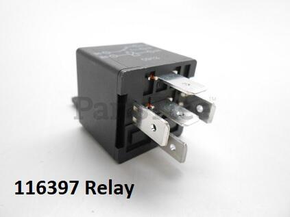

Relay Low oil 116397 List.jpg 1.0.0
116397 relay used 1989-1998 and replaces 116379 and 48-4700
116379 relay used 1992-1993
48-4700 relay used 1994-1998
116397 relay used on 1990 300-Series for the low oil starter circuit and 1990 200-Series and 500-Series as a starter relay.
