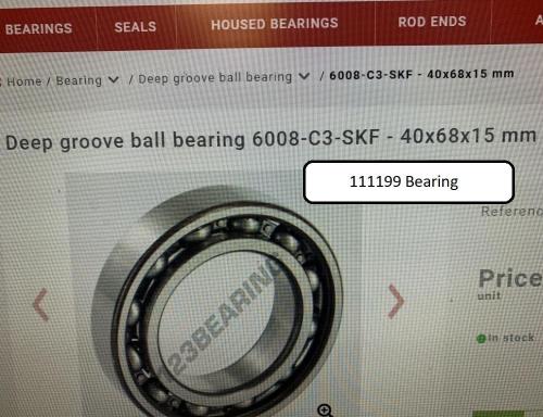

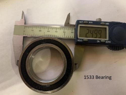

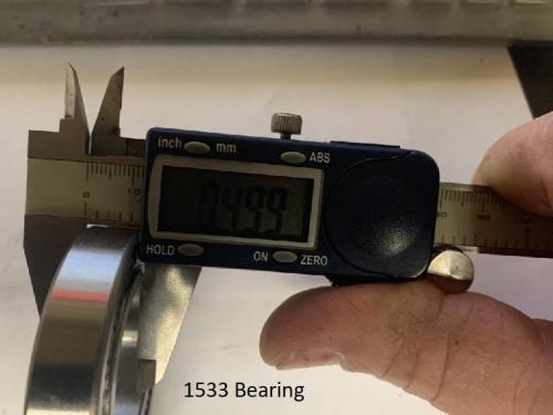

1986 was the model year the differential carrier bearings changed from 1533 to 111199.
1986 308-8 model 21-08K801 - * Uses 111199 differential carrier bearings * (SKF 6008-C3 40x68x15mm) Used model 110996 transmission with 1" axles
1986 308-8 model 21-08K802 - * Uses 1533 differential carrier bearings * (1-1/2x2-1/2x1/2in.) Used model 110996 transmission with 1" axles
1986 310-8 model 21-10K802 - * Uses 111199 differential carrier bearings * (SKF 6008-C3 40x68x15mm) Used model 110996 transmission with 1" axles
1986 310-8 model 21-10K803 - * Uses 1533 differential carrier bearings * (1-1/2x2-1/2x1/2in.) Used model 110996 transmission with 1" axles
1986 312-8 model 21-12K802 - * Uses 111199 differential carrier bearings * (SKF 6008-C3 40x68x15mm) Used model 110996 transmission with 1" axles
1986 312-8 model 21-12K803 - * Uses 1533 differential carrier bearings * (1-1/2x2-1/2x1/2in.) Used model 110996 transmission with 1" axles
1986 414-8 model 31-14K801 - * Uses 111199 differential carrier bearings * (SKF 6008-C3 40x68x15mm) Used model 110995 transmission with 1-1/8" axles
1986 416-8 model 31-16K802 - * Uses 111199 differential carrier bearings * (SKF 6008-C3 40x68x15mm) Used model 110995 transmission with 1-1/8" axles
1986 417-8 model 31-17K802 - * Uses 111199 differential carrier bearings * (SKF 6008-C3 40x68x15mm) Used model 110995 transmission with 1-1/8" axles
1986 512-D model B1-12R801 - * Uses 111199 differential carrier bearings * (SKF 6008-C3 40x68x15mm) Used model 110996 transmission with 1" axles
