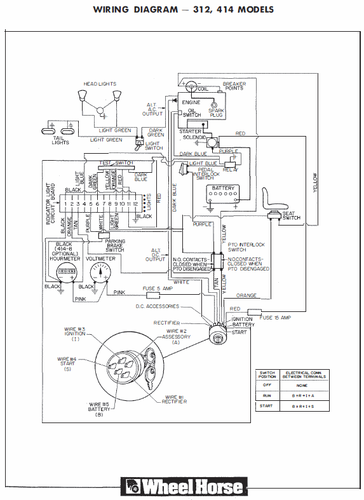

Electrical System Pages 40-47
8 pages 3.3MB

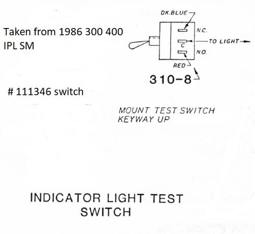

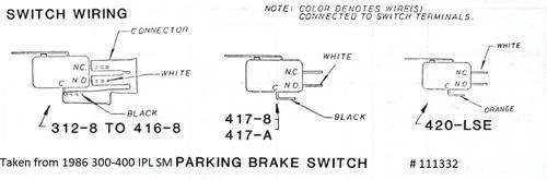

Section 18
Service Information
Page 77 1.5MB

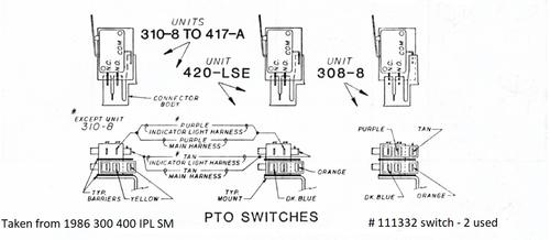

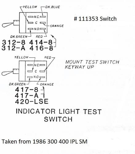

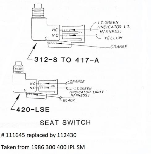

Parking brake switch, Pto switch, Indicator light test switch, Seat switch

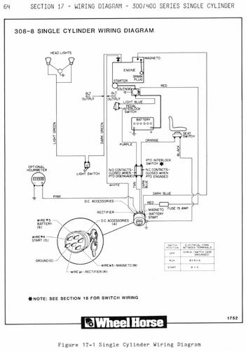

All 300-Series tractors in 1986 have 1" axles and 4 pinion gears.
1986 308-8 8-Speed model 21-08K801
