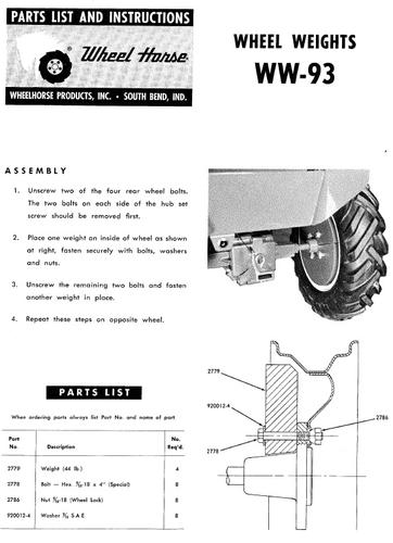

About This File
Model number WW-93 fits inside 15" wheels models 953, 1054 and 1054A 1963-1965 - 44 lbs. each
Operator manual #122
IPL
1 page 210.94KB
Dated 4/1/64
Mounts inside the wheel - 2 pieces per wheel bolted to the rear of the hub
Model number WW-105 fits outside 15" wheels models 953, 1054 and 1054A 1963-1965

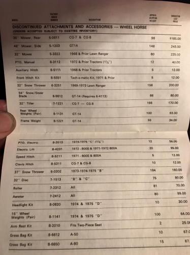

Model number 8-1131 15" wheel weights for the 1969-1973 GT-14 (Approximate shipping weight 100 lbs.)
Model number 8-1141 (Approximate shipping weight 100 lbs.)
Pair of 15" wheel weights to fit 1973 18hp Auto and 1974-1975 D-Series Auto tractors
Also listed for the 1982-1984 C-195 Twin Auto.
There was also a 8-1222 (81222) front weight carrier listed for the 1982-1984 C-195 Twin Auto models. Requires 8-1141 15" Wheel Weights
Model number 8-1160 - 15" wheel weights found in the Attachment Interchange for the 1976-1977 D-Series Auto tractors.
