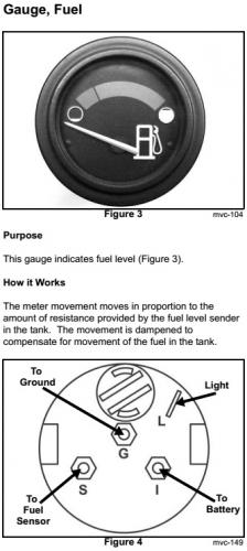

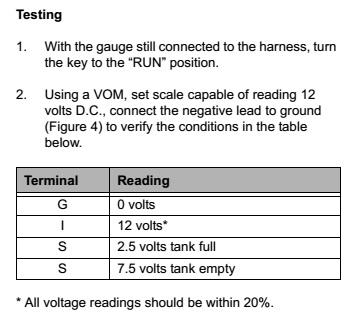

Gauge Fuel Dash unit List.jpg 1.0.0
3 Screenshots
Taken from #492-4761 Electrical manual
Gage Fuel 2002-2003 description
82-12o502* - Correct
82 -12o502 - Not correct
