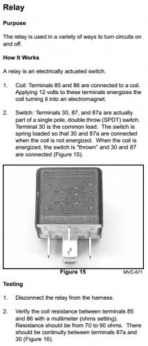

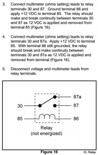

4 Screenshots
Taken from #492-4761 Electrical manual
Common relay 98-7249
Used on 1999 312-8 model 73429
Notice there is a diode or resistor across the coil terminals as illustrated on the relay cover so the polarity of 85 and 86 is important.
85 should be 12VDC +
