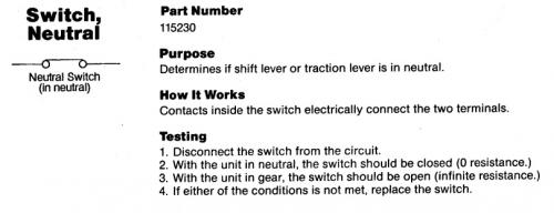

Switch Neutral Clutch 115230 List.jpg 1.0.0
Taken from #492-3203 Electrical Manual
115230 clutch neutral switch used on
1989 model E2-17K502
1990 models 41-20O801, 41-20OE01, R1-18OE02, R2-17K501, R2-17K502
1991 models 22-14O501, 22-14OE01, 31-10K802, 31-12K802, 31-16O803, 32-10B5202, 32-10BE02, 32-12B5A3, 32-12BEA3, 32-12O502, 32-12OE02, 41-20OE02, 51-12KE01, 51-16OE01, R2-12O501, R2-12OE01, S2-12B502
1992 models 22-14O502, 22-14OE02, 31-10K803, 31-12K804, 31-16O804, 32-10B503, 32-10BE03, 32-12O803, 32-12OE03, 41-20OE03, 42-16BE01, 51-12KE02, 51-16OE02, R1-20OE02, R2-12O502, R2-12OE02, R2-16BE01
1993 models 72040, 72041, 72060, 72081, 72101, 73401, 73421, 73501, 73520
1994 models 72042, 72043, 72062, 72063, 72083, 72103, 73421, 73501, 73520
1995 models 72042 x 2, 72043 x 2, 72062 x 2, 72063 x 2, 72103 x 2, 73401 x 2, 73421 x 2, 73501 x 4, 73520 x 2
1996 models 72042, 72043, 72045, 72062, 73401, 73403, 73421, 73423, 73501, 73502, 73521
1997 models 72045, 73403, 73423, 73502, 73521
1998 models 72045 x 2
1999 model 72047
2000 model 72049
