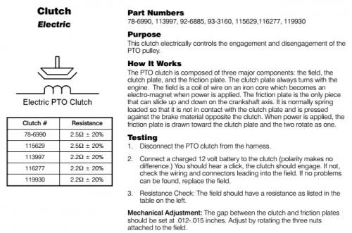

Clutch Electric pto List .jpg 1.0.0
1 Screenshot
Taken from #492-4509 Electrical Manual
 models
112849 replaced by 99-8011 - no applications
113426 replaced by 99-8012 - no applications
113997 replaced by 93-3160
115629 replaced by 99-8011 - no applications
116277
119930
78-6990 replaced by 92-6885
92-1686 replaced by 92-6885
92-6885
93-3160
94-2190
104-2472
2.2 ohms +/- 20% = 1.76 ohms to 2.64 ohms
2.5 ohms +/- 20% = 2.0 ohms to 3.0 ohms
