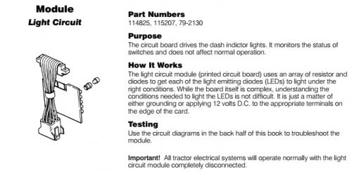

Module Dash light List.jpg 1.0.0
3 Screenshots
Taken from #492-4509 Electrical Manual

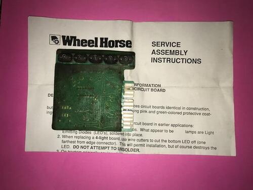

110999 panel introduced in 1986 through 1988 for 312, 414 and 416 models -  Replaced by 115207
111000 panel introduced in 1986 through 1988 for 417 and 420 models -  Replaced by 115207

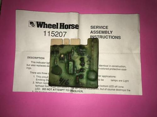

115207 panel introduced in 1989 through 1990 - (Page 3-12 of the Demystification Guide does not apply to the idiot light module. Should be page 3-13)
114825 idiot light module used 1990-1997 and replaced by 115207 - (Page 3-12 of the Demystification Guide does not apply to the idiot light module. Should be page 3-13)
79-2130 idiot light module used 1991-1997 on the 520 models - (Page 3-12 of the Demystification Guide does not apply to the idiot light module and page 3-13 is a different module. 79-2130 should not be listed.)
82-12o502* - Correct
82 -12o502 - Not correct
110999 Light circuit board used on
1986 models 21-12K802*, 21-12K803*, 21-12KE01*, 21-12KE02*, 22-11B502*, 22-12TE01, 31-14K801*, 31-16K802*
1987 models 21-12K804, 21-12KE03, 31-14K802, 31-16K803, 32-11B301, 32-11B501, 41 -18KE01, B2-11B392
1988 models 21-12K805*, 31-14K803*, 31-16K804*, E1-12K801*
111000 Light circuit board used on
1986 models 31-17K802*, 31-17KE02*, 31-20KE01*
1987 models 21-12K804, 21-12KE03, 31-14K802, 31-16K803, 31-18K801*, 31-18KE01*, 41 -18KE01
1988 model B1-16O801*
115207 Light circuit board used on
1988 models 22-17KE01*, Not used on 22 -13KE01
1989 models 22-17KE02*, Not used on 22 -13KE02
114825 Light circuit board used on
79-2130 Light circuit board used on
