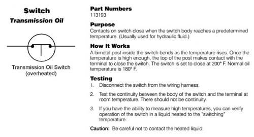

Sensor Hydro oil temperature 113193 List .jpg 1.0.0
Taken from #492-4509 Electrical Manual

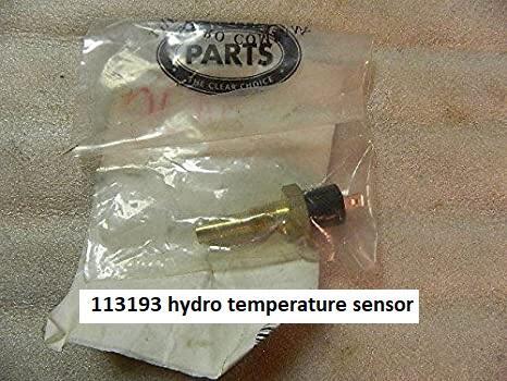

113193 hydro oil temperature sensor
Normal oil temperature is 180 degrees F.

113193 switch used on
1988 models 31-16OE01, 31-18OE01, 31-20OE01, C1-20OE01, E1-18OE01
1989 models 31-18OE02, 31-20OE02, C1-20OE02, E1-18OE02, R1-18OE01
1990 models 41-20O801, 41-20OE01, R1-18OE02
1991 models 41-20OE02, R1-20OE01
1992 models 41-20OE03, R1-20OE02
1993 models 73501, 73520
1994 models 73501, 73520
1995 models 73501 x 4, 73520 x 2
1996 models 73501, 73502, 73521
1997 models 73502, 73521
