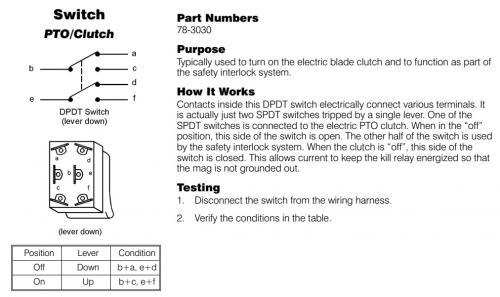

Taken from #492-4509 Electrical Service Manual

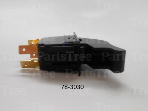

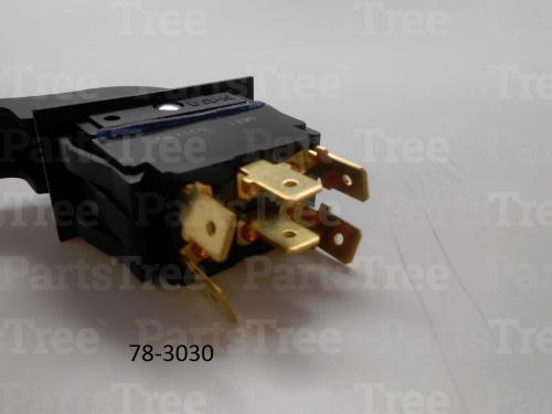

78-3030 Pto switch used on
1991 models 22-14O501, 22-14OE01, 32-10B502, 32-10BE02, 32-12B5A3, 32-12BEA3, 32-12O502, 32-12OE02, R2-12O501, R2-12OE01, S2-12B502
1992 models 22-14O502, 22-14OE02, 32-10B503, 32-10BE03, 32-12O503, 32-12OE03, 42-16BE01, R2-12O502, R2-12OE02, R2-16BE01
1993 models 72040, 72041, 72060, 72081, 72101
