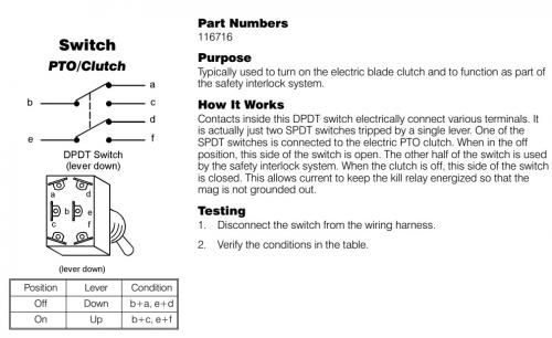

Switch Pto Electric clutch Toggle 116716 List.jpg 1.0.0
3 Screenshots
Taken from #492-4509 Electrical Manual
82-12o502* - Correct
82 -12o502 - Not correct

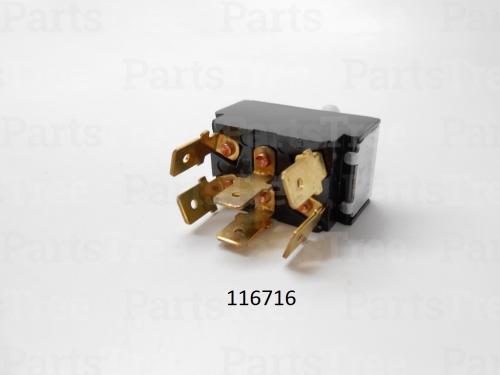

Pto switch 116716 used on
1990 models 32-10B501, 32-10BE01, 32-12O501, 32-12OE01, 32-16BE01
1991 models 32-12O5A1, 32-12OEA1, 32-12B5A2, 32-12BEA2
