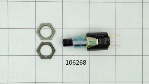

106268 Push button switch NO=Normally open - black knob
Used on
1978 B-81 4-Speed model 82-08BP01 [Have TIPL Wiring]
1978 B-111 4-Speed model 82-11BP01 [Have TIPL Wiring]
1980-1981 B-Series
1978-1983 C-Series
