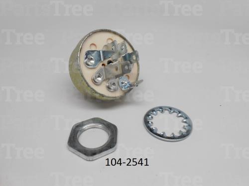

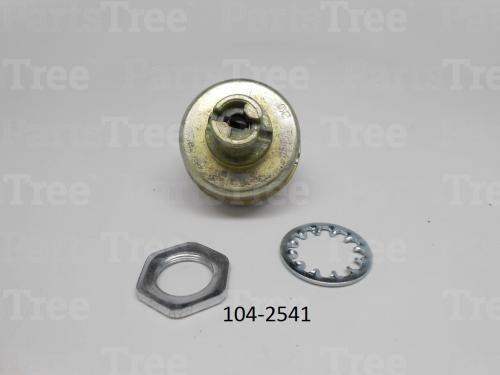

88-9830 replaced by 104-2541
6-terminal 3-position for battery ignition - Often used to control a kill relay for magneto ignition
Used on the XL-Series tractors and Time Cutter zero turn models
Switch rotated to put single terminal at the top
