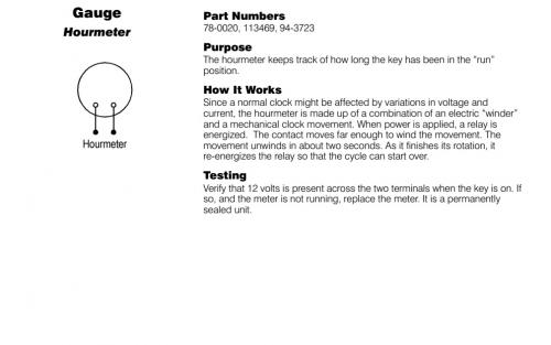

About This File
Taken from Demystification Guide #492-4509
1 page 101KB

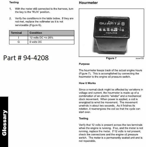

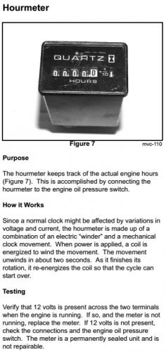

Gage Hourmeter
Taken from Demystification Guide #492-4761
Hour meter 2002-2003 description
Operating voltage 12 volts +/- 20% = 9.6 volts to 14.4 volts

113469 Round Hour Meter used on - (Still available January 22, 2021)

78-0020 Round Hour Meter used on - (replaced by 66-2950)

94-3723 Round Hour Meter used on - (replaced by 66-2950)

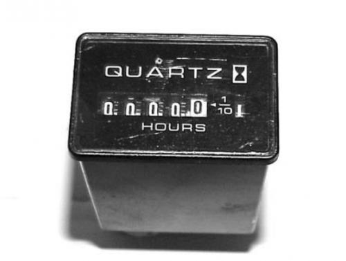

94-4208 Rectangular Hour Meter used on - (Still available January 22, 2021)
1996 models 72045, 72046, 72064, 72085, 72102, 72104, 72110
1997 models 72045, 72046, 72064, 72085, 72102, 72104, 72110
1998 models 72045 x 2, 72046 x 2, 72064 x 2, 72085 x 2, 72102 x 2, 72104 x 2, 72110 x 2, 73428, 73448 x 2, 73470, 73540, 73541, 73545, 73546, 73550, 73551, 73560
1999 models 72047, 72048, 72070, 72086, 72105, 72106, 72115, 73429, 73449, 73471, 73542, 73547, 73552, 73561, 73570, 73580, 73590
2000 models 72049, 72050, 72071, 72087, 72107, 72108, 72116, 73429, 73449, 73471 x 2, 73542 x 2, 73547 x 2, 73552, 73561 x 3, 73561SEI, 73570, 73580, 73590, 74590
2001 models 72051, 72052, 72072, 72087, 72107, 72108, 72116, 73429, 73449, 73471, 73542, 73547, 73561, 73580, 73590, 74590
2002 models 72051, 72052, 72072, 72087, 72107, 72108, 72116, 73450, 73542, 73561, 73570, 73590, 74590
2003 models 72107, 72116, 72200, 72201, 72202, 73450, 73542, 73561, 73570, 73590, 74590
2004 models 72200, 72201, 72202, 72211, 72212, 73450, 73542, 73561, 73590, 74590
2005 models 72200, 72201, 72202, 72211, 72212, 73450, 73561, 74590
2006 models 72211, 72212, 74591
2007 models 73450, 74592 x 2
2008 models 74592 x 2
2009 models 74592, 74593
2010 model 74593
2011 models 74593 x 2
