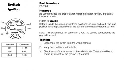

1 page 166KB from Demystification Guide #492-4509

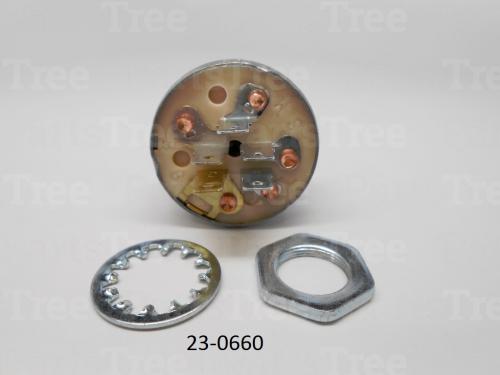

Rotated switch to place single terminal at the top
1 page 142KB
How to troubleshoot

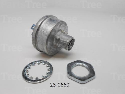

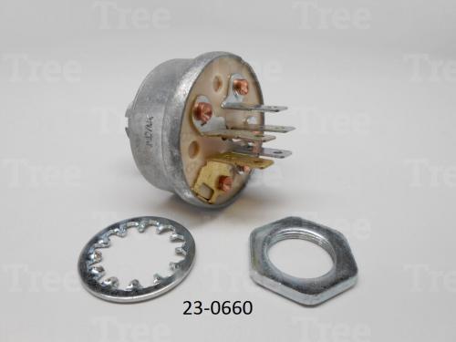

23-0660 switch for magneto ignition
5-terminal 3-position key switch
This switch requires a starter solenoid
Tractor Switch Ignition Magneto ignition with electric start 23-0660
(Threads 5/8"-32) 5-terminal switch replaces 63-5630
23-0660 5-terminal available 08/08 $23.53 from RCPW Stens replacement 430-538
Used 1974 thru 2007
