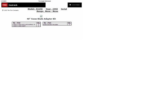

Parts list from Toro Master Parts Viewer
1 page 97KB

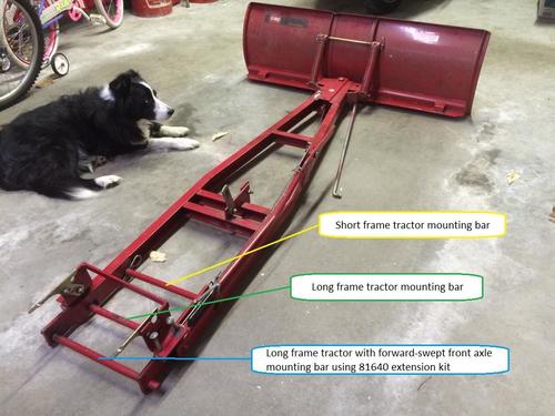

Required on the 520-Series tractors with the forward swept front axle.
1988-1989 model 8-1630 or 81630 replaced by 8-1640 or 81640

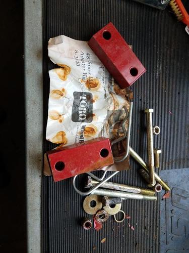

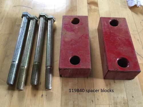

The 1990 model 520-8 requires two 1" x 1-1/2" spacer blocks 119840 to go between the hitch and the axle housing. This spaces the hitch down so the frame clears the drive pulley.

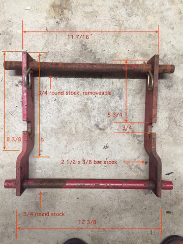

1990 Dozer blade A-frame extension adapter model 81640 or 8-1640
1991 Dozer blade A-frame extension adapter model 81640 or 8-1640
1992 Dozer blade A-frame extension adapter model 81640 or 8-1640
1993 Dozer blade A-frame extension adapter model 81640 or 8-1640
1994 Dozer blade A-frame extension adapter model 81640 or 8-1640
1995 Dozer blade A-frame extension adapter model 81640 or 8-1640
1996 Dozer blade A-frame extension adapter model 81640 or 8-1640
1997 Dozer blade A-frame extension adapter model 81640 or 8-1640

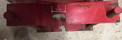

Link to photos with dimensions
